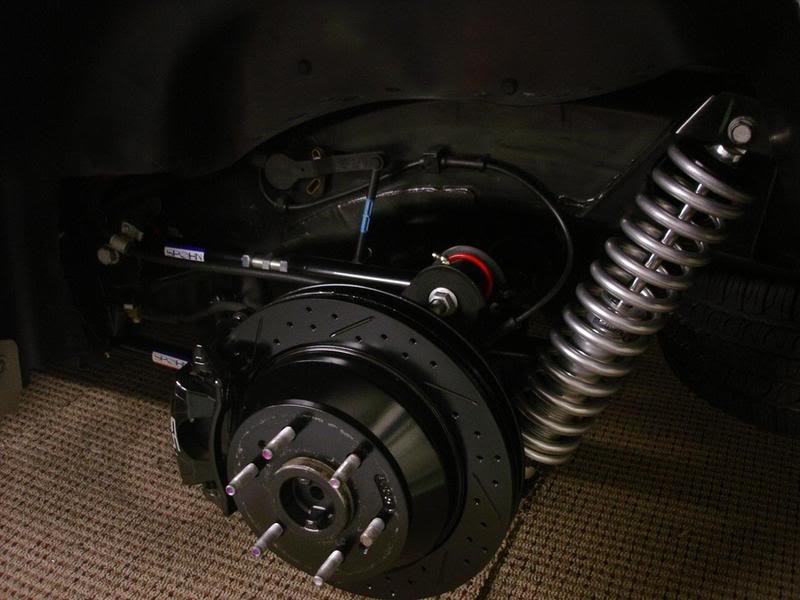

Why don't they release it? It makes a huge difference to know if you have 200lb linear springs or 900lb progressive rate springs. How do you match a spring to a damper without knowing its rate - especially on a drop? If you reduce the ride height by 3" you need to increase the spring rate enough to compensate for the loss of travel to keep off the bump-stops (even if you cut the bump stops which really you shouldn't have to do if the spring rate/damper combo is proper). If you reduce the bump travel by 50% how much do you have to increase the spring rate to only hit the bump-stops the same amount as stock? I'll bet a dollar its not 50% more than stock which is more than any "sport" spring increases the rate over stock. On top of that you have to add enough additional spring rate to compensate for the specific driving conditions and driver's driving style and in the case of trucks and SUVs whatever cargo you routinely carry (kids, groceries, tools, luggage, pets, whatever) and pretty quick you are tripling the original spring rate and that's just a starting point. If you don't, the dampers are going to blow their guts out in short order. Well, guess what happened? The dampers blew their guts out in short order.
I'd like to see someone try a set of very high progressive rate coilovers with double adjustable dampers and some kind of camber adjustment on one of these vehicles. I suspect the spring rate that would be necessary on a 3/5 drop would be well over 1000 lbs and 1200-1500 wouldn't surprise me.
