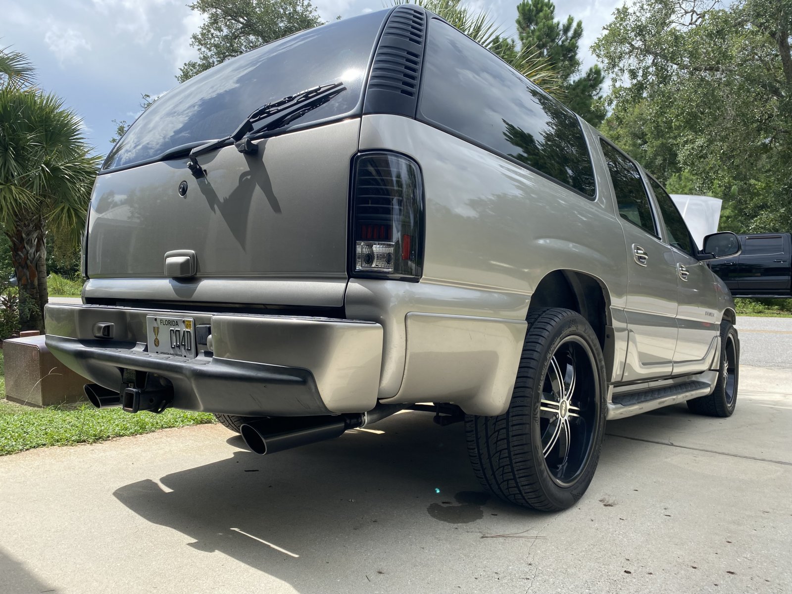

It was now time to make it where I can hear all 366ci of this LQ4. Quick trip to my go-to exhaust shop and I got x2 Jones Performance Flowpacks (single chamber) and 4.5” black slant-tip exhaust tips installed. I was honestly unaware that these Denalis came true-dual from the factory (meaning no Y pipe, 2 mid-pipes connect to a 2-in, 1-out muffler). I was actually impressed by how good it sounded with stock manifolds, and it took the wife some convincing to get used to. It’s loud enough to turn heads when accelerating but it doesn’t drone or overpower the stereo. I’m not even sure if I want to go with headers yet because it’s already pretty damn aggressive.

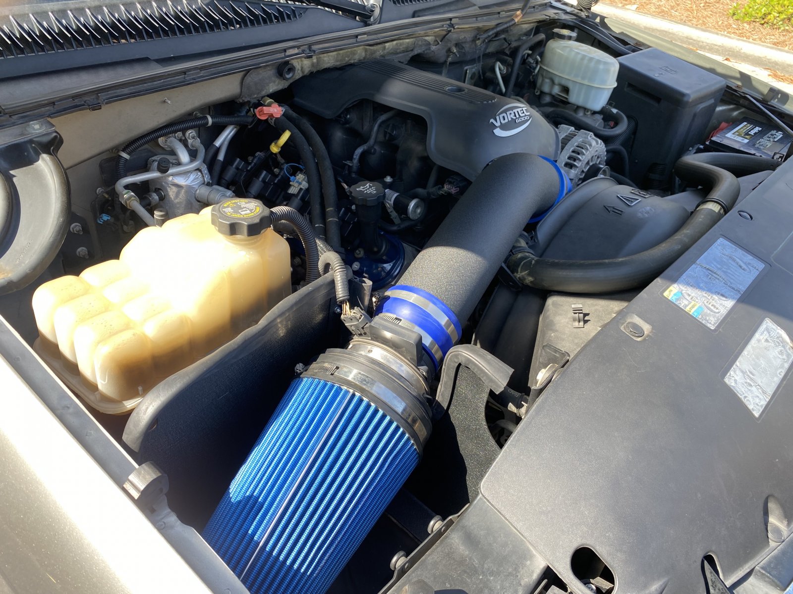

I also replaced the chrome intake with a black one with blue couplers to match the painted valve covers. I know there’s no power to be gained until I get tuned, but who doesn’t love that intake “wooosh”?
Those "cold air intakes" actually suck in underhood hot air. The stock air boxes are actually pretty good for sucking in cold air through the passenger side fender. What a lot of guys do is open up the intake side of the airbox--part that's butted up against the fender--then use some foam tape from HD, then get a good air filter. Up to you if you'd want to use a k+n. Some guys think the oil gums up the maf.

Nice work! I will say it’s the first time in my life hearing Atlanta referred to as “up north” :lol:
lol what can I say? I'm from...
It had the same style intake on it when I got it so the factory air box wasn't an option, but I am 100% tracking the heat soak issue. I have yet to data log to check my IAT, but I am sure this cheapo intake doesn't seal to the hood like a Rotofab. I had a K&N on my Gen 5 and it helped, granted in FL when it's 90+ half of the year and with engine temp added even ambient isn't ideal for power.
If I can, I would like to find an AWD dyno so I can get a good baseline. maybe a junkyard will have a decent OEM airbox I could clean up to compare with. The only "true" CAI I've had was on my G37, which had dual throttle bodies and the intake ran the filters in front of the radiator right behind the grille. It was nice, until you get stuck behind a semi in the rain lol

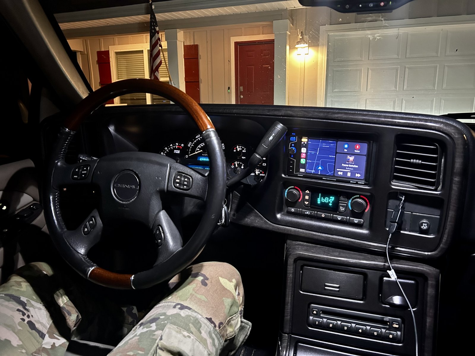

Okay, we’re almost there! After swapping in the new gauge cluster it just made the rest of the interior look clapped out. I once again did a TYF deep dive to devise a plan to start restoring the interior.

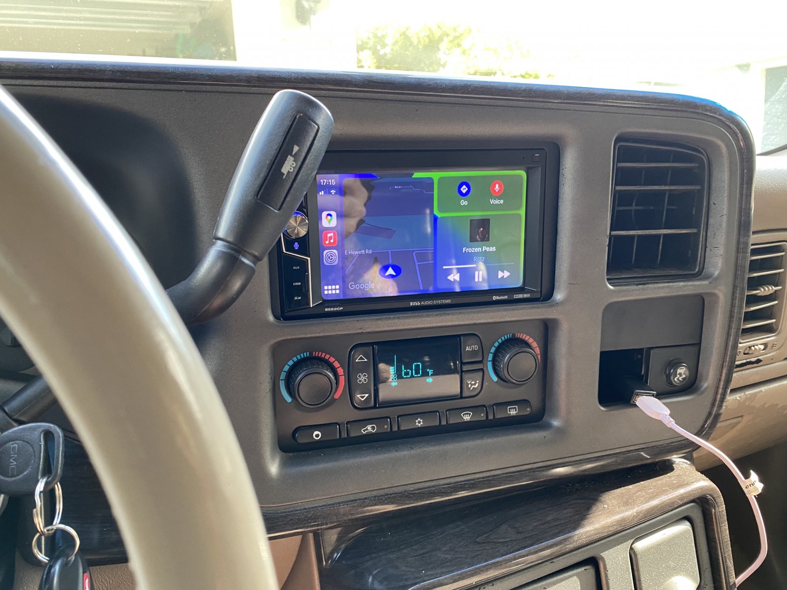

I decided that I wanted to go with a black/tan two tone theme and retain the Denali wood trim. I personally think the dark wood in the Denali was the best accent GM offered in this platform. I started with a black overlay from Dashskin and some black (grayish) AC vents from a Yukon my dad had. I didn’t think it looked right with the glovebox and lower driver’s side dash panel tan so I decided to black it all out just on the dash, I haven’t touched the doors yet. I used vinyl and fabric paint from my local parts house. It came out pretty good honestly, I was a bit skeptical about the “oh shit” bar since it’s leather.
After that I pulled the dash bezel and center console out and the wife and I split the load sanding the gooey gray finish off, being careful not to scratch the wood pattern borders by taping them off. The color we (she) chose was GM Iridium and we used Duplicolor factory match. It’s darker than the OEM coating plus it’s metallic like the exterior. I think it compliments the wood well.
^ in this pic, I had attempted to paint the glovebox color is what was supposed to match the 922 RPO code, as you can see, that was FALSE! lol
Next target is the steering wheel. And thanks to a couple of members here, I know exactly what I am looking for. I already have new buttons, I’m just waiting for the wheel I want to pop up where the seller doesn’t think it’s made of GOLD.

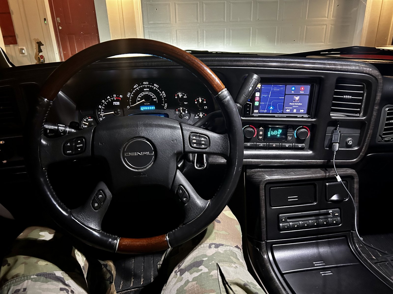

Other than a few minor things like the bully bar, painted calipers, etc. this is pretty much where I am at today. I finally found the wheel I wanted for a good price so I got that ordered and was able to get a black steering column cover off of a Tahoe at my dads. Spent the weekend drinking moonshine and tinkering with my brother’s 5.3 build for his Nova and some other projects around the shop. The pewter is growing on me, and my wife likes it (more importantly) so now I think I’m just going to repaint it the same color.

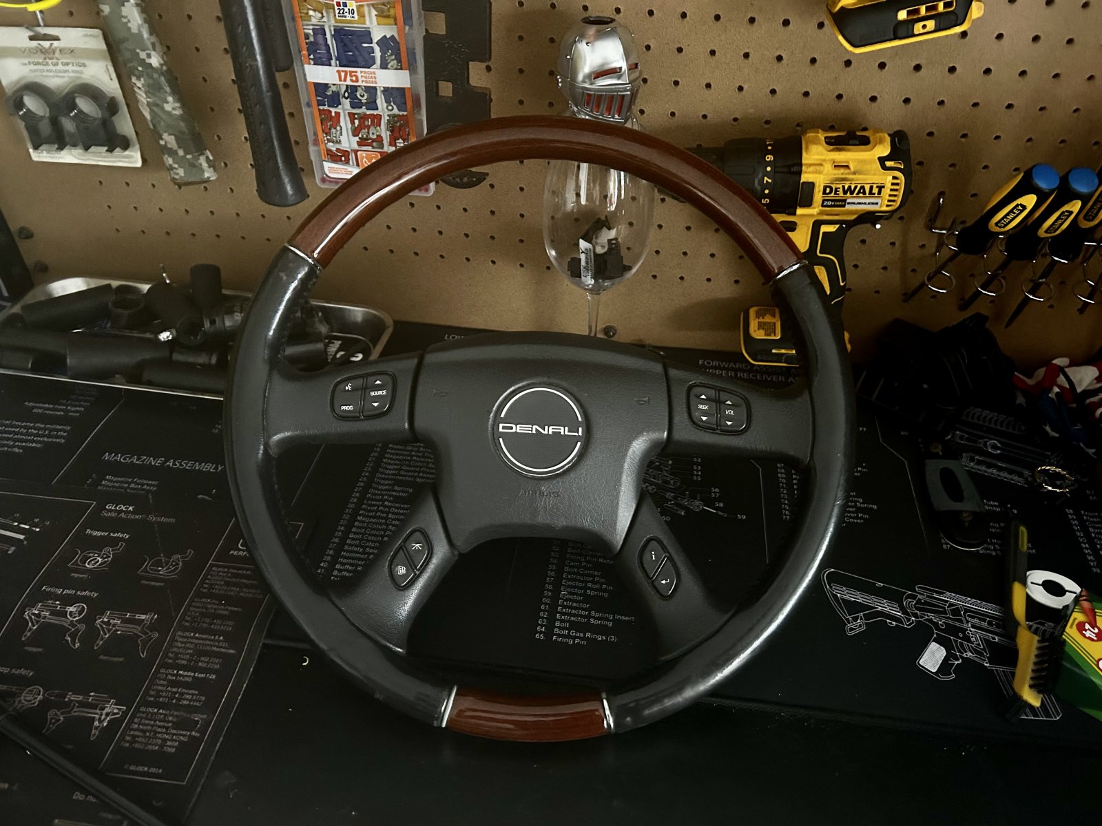

I got my steering wheel in yesterday. It’s from an Envoy Denali and while it’s not in perfect shape, it’s pretty clean overall, and a vast improvement aesthetically over the factory Denali wheel. Plus the price was right (these things can get $$$ if you’ve looked at them) Hopefully I can find some time to install it this week!
