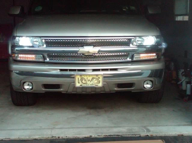

I just drove the truck and when I made a left turn, the flasher is going at double speed. Right one is fine.
I looked at the lens where the turn signal is and the glass is all misted up inside.
Could it be moisture in the bulb connection?

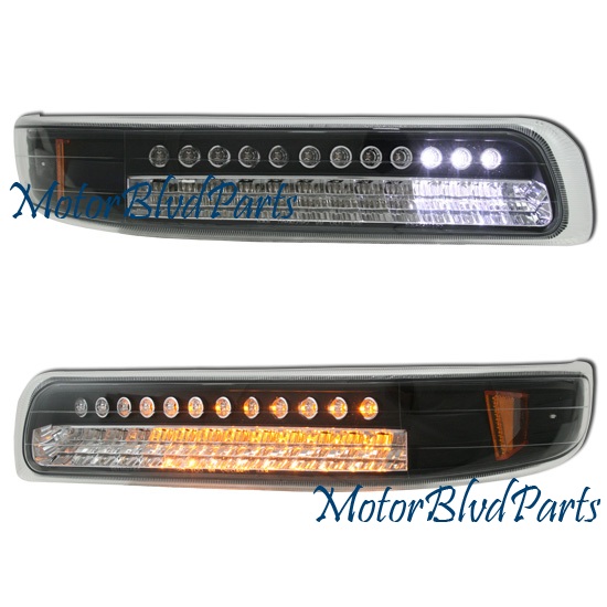

They let in moisture so I need to replace them.
What do you think of these LED bumper lights?
