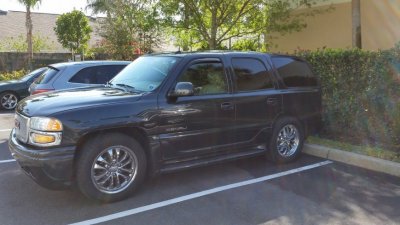

here is how it sits about 1.5" down in front and 3" in the rear. cant wait to look like that again with the new shocks. I know its nothing special but I was able to do this on the cheap and its still way better than stock. i only have $290 into it with the rear 5125s. 22" CK156 or CK375 would be awesome. doubt itll happy anytime soon though.
the setup is:
lowered front with stock keys
belltech 5303 rear springs
belltech shock extenders
KYB gr2s front
(in the mail now) billstein 5125 rear
belltech 4923 front jounce stops
cut stock rear bump stops
i have a set of used (free) rear endlinks im going to cut, sleeve and weld to level out the rear sway bar. i need to save where i can. $90 for DJMs just isnt possible for me.
that'll be it for a while.
