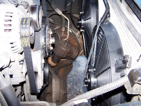

Here are some of the post install pics.
BBTune new Computer;
Flex-A-Lite Temp Controller;
Replacement Alternator Pulley;
Replacement Crank Pulley;
Underdrive Pulleys;
It's a Cavern in there without the Mechanical fan and shroud;
Efan Install;
She aint pretty, but she works!

It's hard to see in the pics, how are the e fans mounted to the radiator? I've looked into e-fans, but all of the "kits" are $500-$600. I do like that they have the aluminum shroud however which helps make them more efficient.
Glad to hear you like the BB tune!
I too, didn't want to spend over $500 for a kit.
I bought the fans from this Ebay vendor;
And they install via custom plastic zip ties that go through the rad. Each kit comes with four of them, but I only used two at the top to hold in the fan. The bottoms rest and sits in place on the existing fan shroud lip.
There is a possibility of the rad getting punctured maybe, but just be gentle on install. If it causes me any kind of grief I'll upgrade the rad, and think about a shroud.
I was wondering about the need for a shroud that the kits have too. But these fans come with one built-in for it's size. It's not a perfect fit for the rad, and doesn't cover the entire surface area, but if you mount the e-fans close enough to the rad it should be ok. Like I said, they hardly ever come on, just at idle and stop-and-go traffic. Normal hwy driving, they just simply don't come on.
So far, if I had to do this again, I would still pick the cheapo fans and not the kits. It's not worth the extra money. Maybe next summer things will change. I'm sure i'll post updates, if there are any. :sleepy10:
It's the last picture on the bottom that shows the plastic zip ties.
