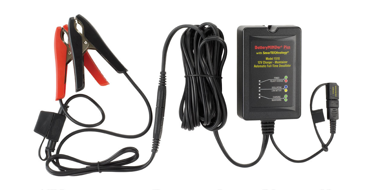

100% correct by him starting the vehicle with remote starting for 10min at a time the battery will not charge he is killing the battery everytime he starts and not driving it. Yusuf you need to buy a Battery maintainer for AGM battery's there is a difference between the old style chargers and one for the AGM battery. With these new vehicles computers, the battery is always working for the reasons said above.

I agree with above, don't start it and let it run for 10 min. It could take up to 30 miles or 15 min of city driving to replace the juice used to start it.
I put one of these on my cousins Jeep Cherokee. Takes 5 min to hook up. She drives about 3,000 miles a year and it sits for weeks and goes dead. She's a snow bird, winters in FL and summers in Upper Michigan.
Battery Tender 3 AMP Car Battery Charger - Automotive Switchable 6/12V, Fully Automatic Battery Charger and Maintainer for Cars, SUVs, and Trucks - 6V/12V, 3 AMP Charger - 022-0202-COS

Note, battery in the 21+ is an AGM, and you should get a tender or charger which can handle the slightly different charging profile and float voltage of an AGM battery to maximize it's life.
Stbentoak
Jul 20, 2020
1,648
1,861
The de facto standard charger for most OEMs is the CTEK brand. I’ve had them for years, they work impeccably on AGM’s.
I’ll leave them on for months at a time. Battery is always in perfect and peak condition.
