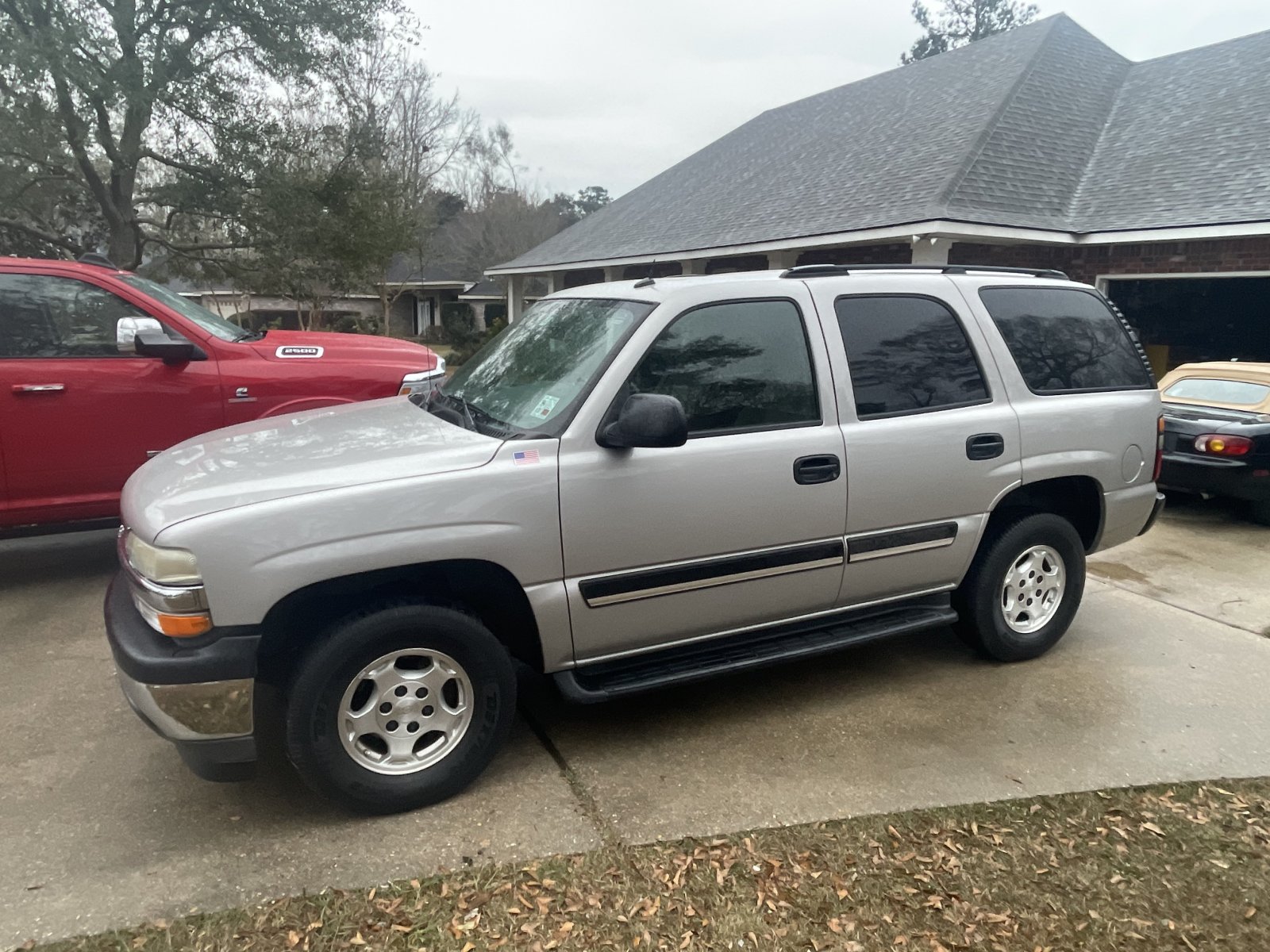

Going to use this as my daily for a few years, currently at 194,000 miles.
Bought from the original owner, who I know. Used by his wife as a daily driver, no towing (no hitch!).

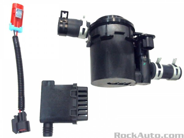

There's a check engine light on for the evap system. Will investigate that tomorrow. Hoping for an easy fix.

The evap system will give you fits. I have read many threads where members replaced 1 or 2 parts and then they still have an evap code come up. I did my new fuel pump and while was apart, replaced the entire evap system. No problems.
