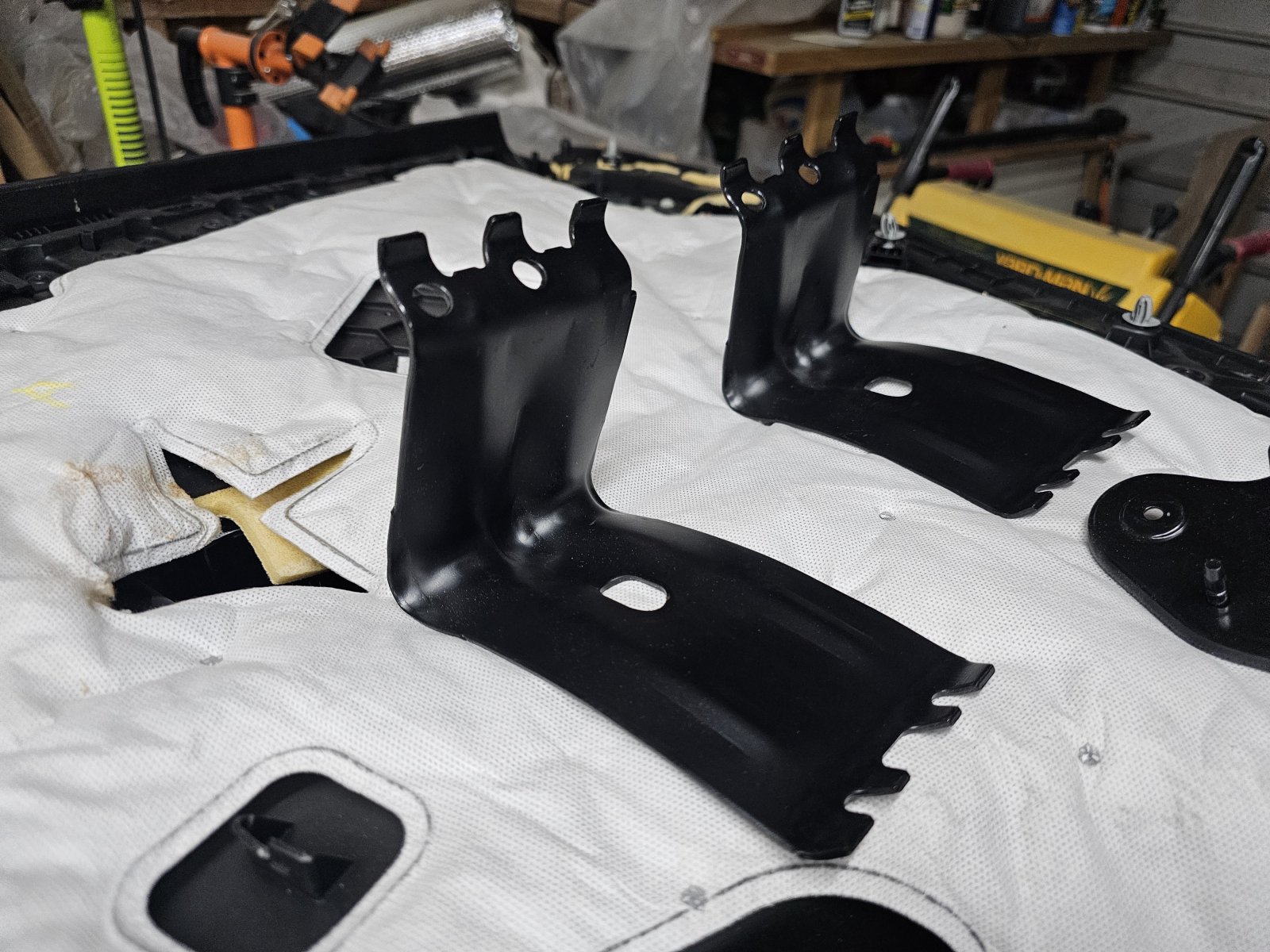

I bought a police vehicle, the console and door panels were sitting in the back. It had these two brackets sitting in the console that was sitting in the very back. i have no idea what they are for or where they go. There are no markings on them, and they are the same, not a right and left version.
Anyone have any ideas?

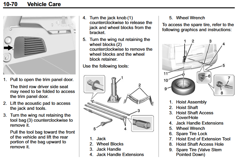

They're wheel chocks (blocks) that go with the jack. They also can be used to elevate the jack to use when there are issues lowering the spare tire. From the manual:
