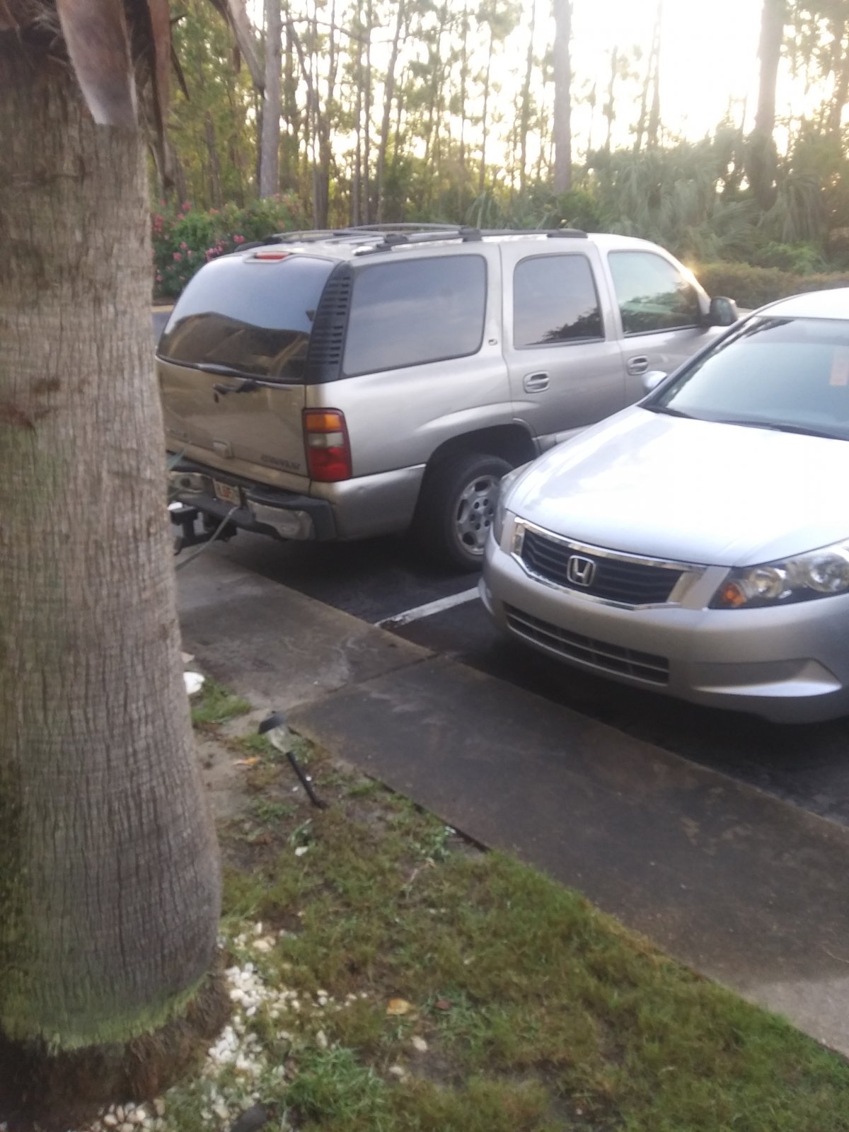

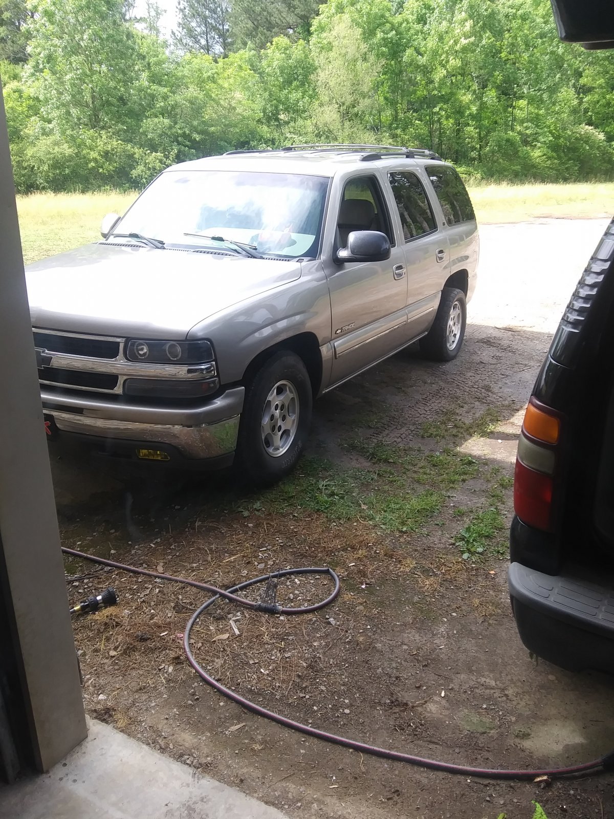

Hey guys been a minute since i visited. I've been working on fathoe for about a year now. Had a few hiccups along the way but way more fun than i should. Heres the rundown.
5.3 block stock bottom end with aftermarket 4.8 flattops , tsp cam, clevite bearings, melling ** pump and double roller chain. Shaved 243 heads. Full bolt on, egr + evap delete. Started with a mail orde20190603_063214.jpg r blackbear tune then purchased a mvpi2. Yank 3000 stall and 4.11 with a Detroit spool. Im running 26.4 inch tires20190603_063214.jpg 3inch drop coils in back keys turned down in front.
Unfortunately i burned the yank up and am back on the stock stall but the overall combo works pretty good. Its alot of fun on the street
Here she is in Panama City Beach this mornin after driving 400 miles last night returning 17 mpg goi 70-75 turning 2700 rpm.
And yes the fronts getting the same toyo proxes as the back they just haven't arrived yet. Im running a 1.5 spacer to help the 255/50's look a little better

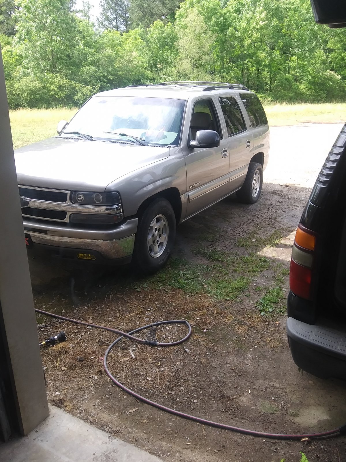

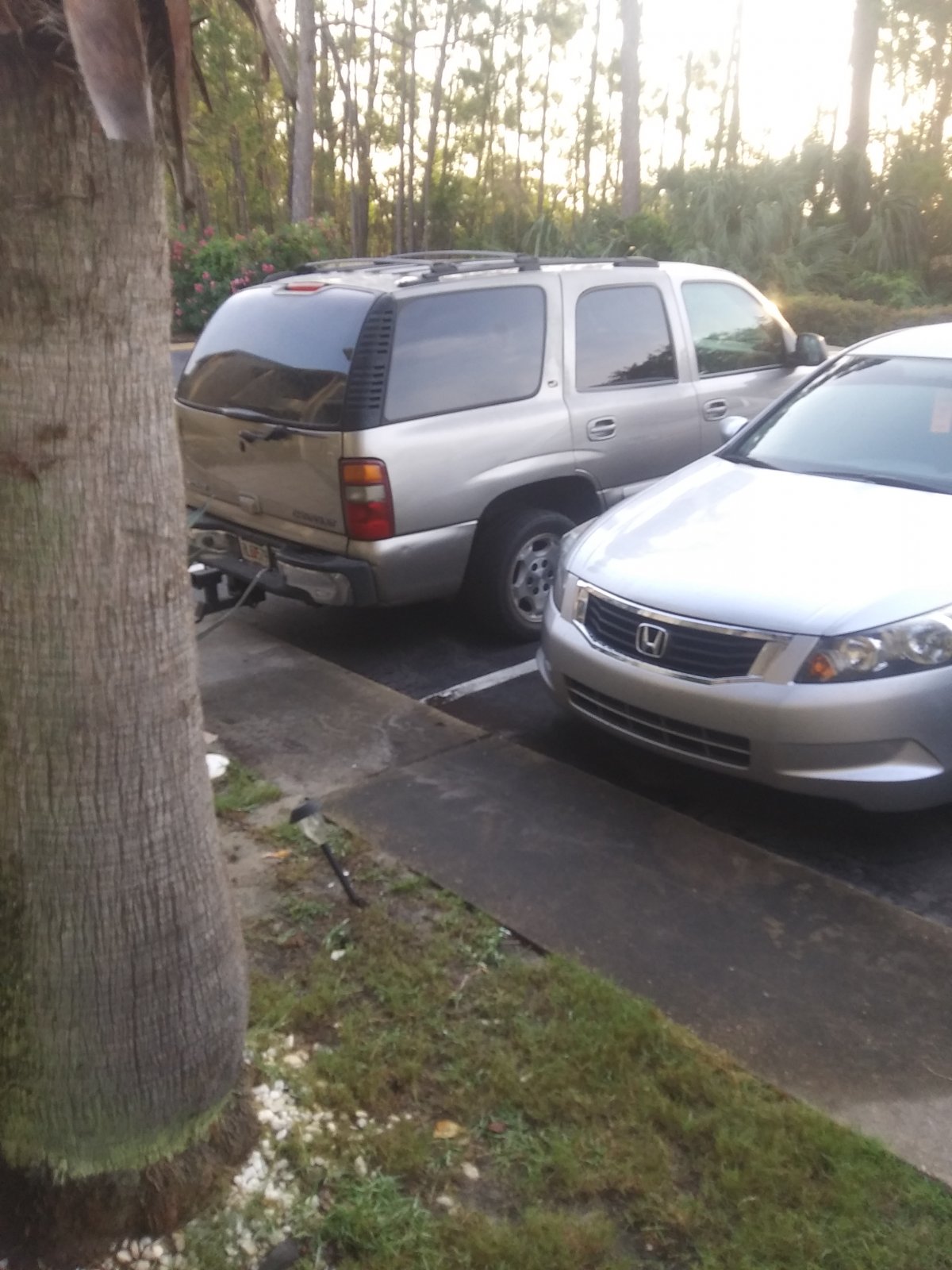

5.3 block stock bottom end with aftermarket 4.8 flattops , tsp cam, clevite bearings, melling ** pump and double roller chain. Shaved 243 heads. Full bolt on, egr + evap delete. Started with a mail ordeView attachment 224178 r blackbear tune then purchased a mvpi2. Yank 3000 stall and 4.11 with a Detroit spool. Im running 26.4 inch tiresView attachment 224178 3inch drop coils in back keys turned down in front.
Sounds capable. Gotta post a vid of it running or in action. How'd you burn up the tc?
