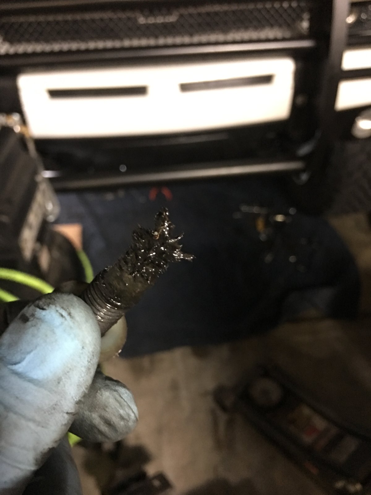

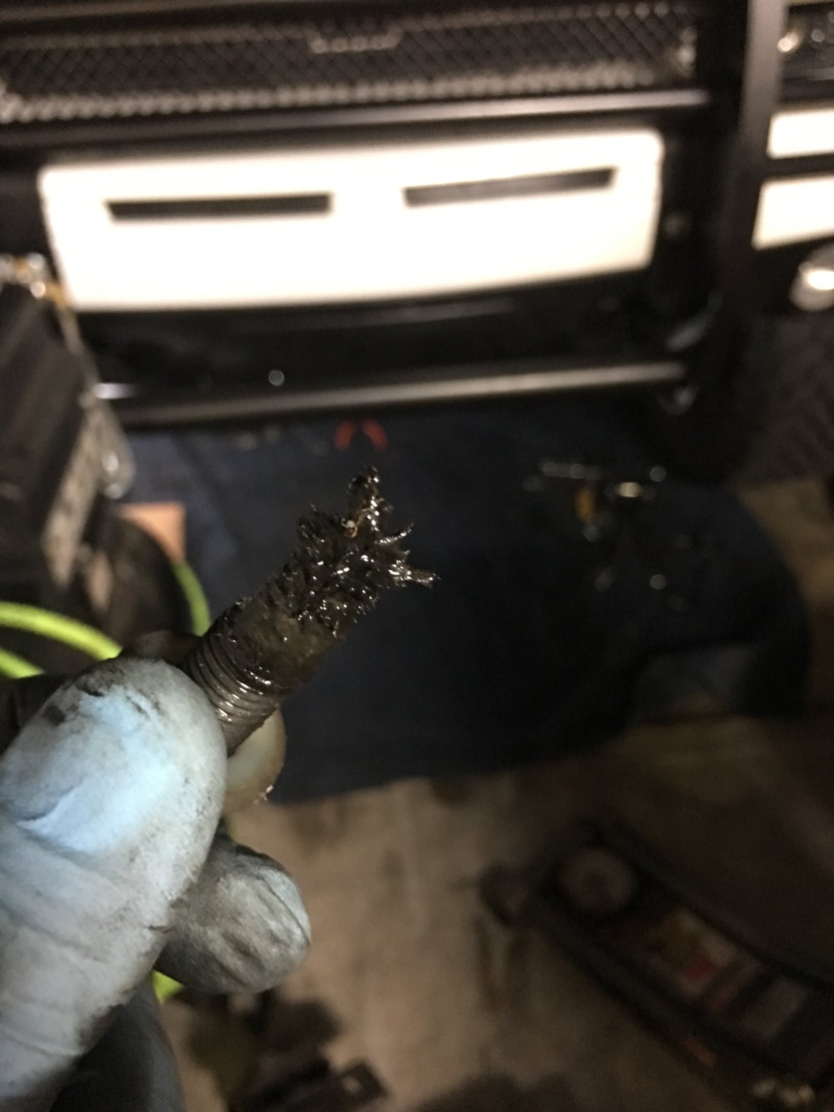

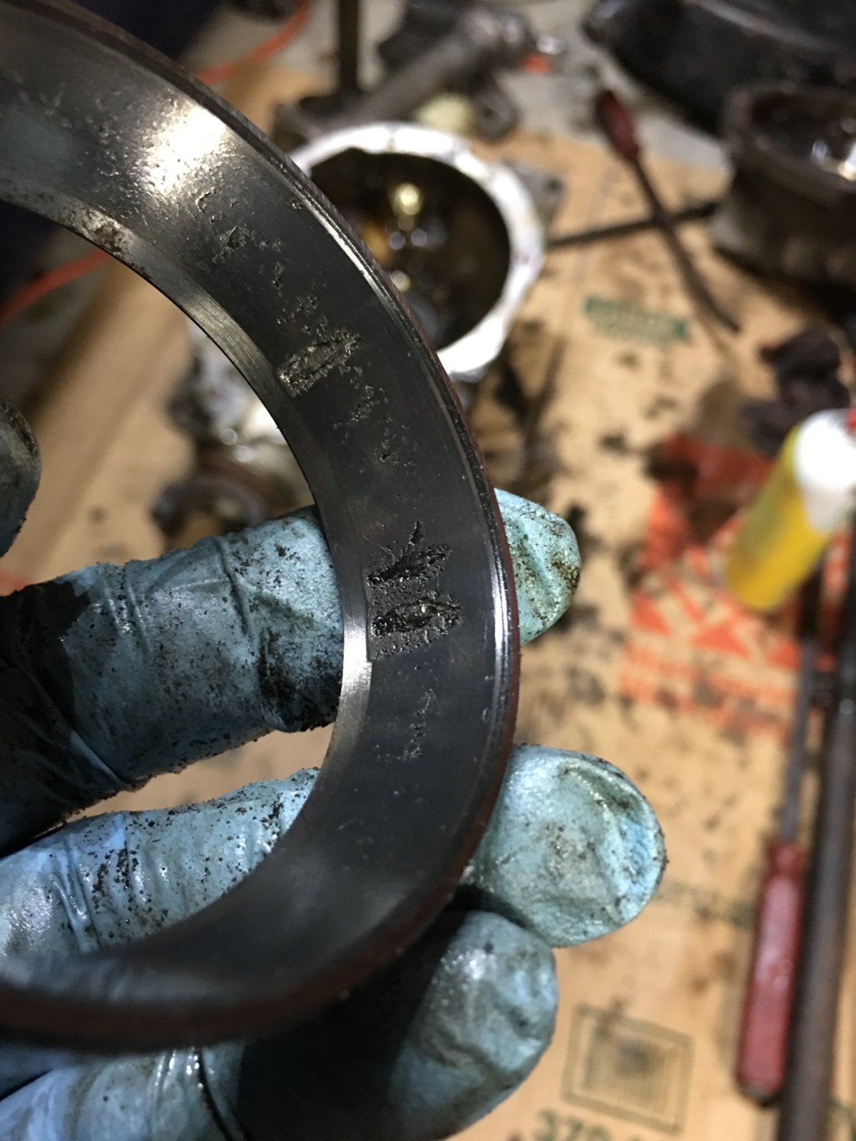

II rebuilt/overhauled my front diff and regeared to 5.13’s in just over 2.5 hours and that’s completely reinstalled with fluids filled.
My carrier bearing races were toast!
