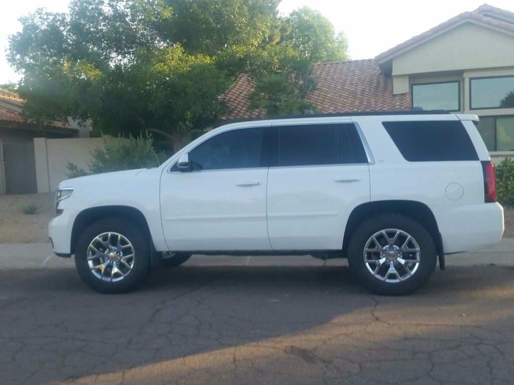

The O.P. did not mention Magna or not, but I have 2.5 front level kit on my 15 Tahoe LT, 4x4 with OE rear air suspension (Z82 & Z85). With no rear changes, it sits level with no clearance issues with 275/70/20 (35.16 x 10.83). The front, below-bumper 'snowplow' was shortened prior to the wheel/tire change from 18's, so I cannot vouch for stock air dam clearance, but that silly thing should be shortened regardless.
