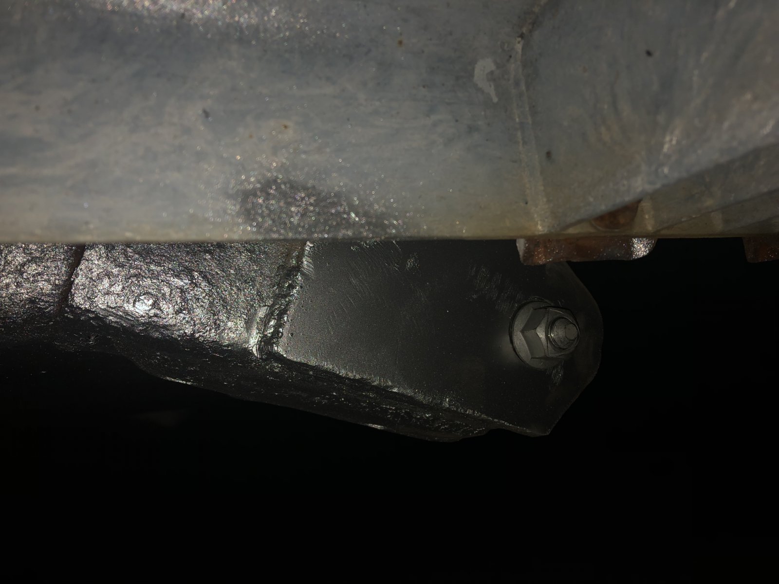

Just a wrap up:
1st. Sorry I posted in the incorrect forum, and thank for moving my thread to the correct forum/sub forum.
2nd. $250’worth of
Parts (new, Moog upper and lower control arms, new bolts and nuts, from the GM parts store), AND some steel plates (8 to be exact), and voila ………. A fixed Tahoe. I dare say my Tahoe rear end is STRONGER than factory. Of course a lot of sweat equity.
Here’s a photo of the same side of the truck that was in the previous (cracked) photo on this thread. I took it just now (at night). Overall, I’m a happy camper. It pays to know a good welder.

Just a wrap up:
2nd. $250’worth of
That’s awesome, glad you got it fixed!

Just discovered this thread. Did the same with my 2007 Yukon. Son-in-Law donated it to me, and it had broken completely. He still drove it from repair shop to repair shop, no one wanted the job. Says it drove OK, just had this "clunk" sound. The rear end is still attached by three trailing arms, so it didn't change much.
My Son is the Senior Welding Engineer at a well-known prototype automotive plant in SE Mich, and I agree "It pays to know a good welder". He did just the driver's side, and used heavy plates also. I still don't have the tank back in, heavy rust on all the fittings causing difficulties, but I am sure it will last a long time.
