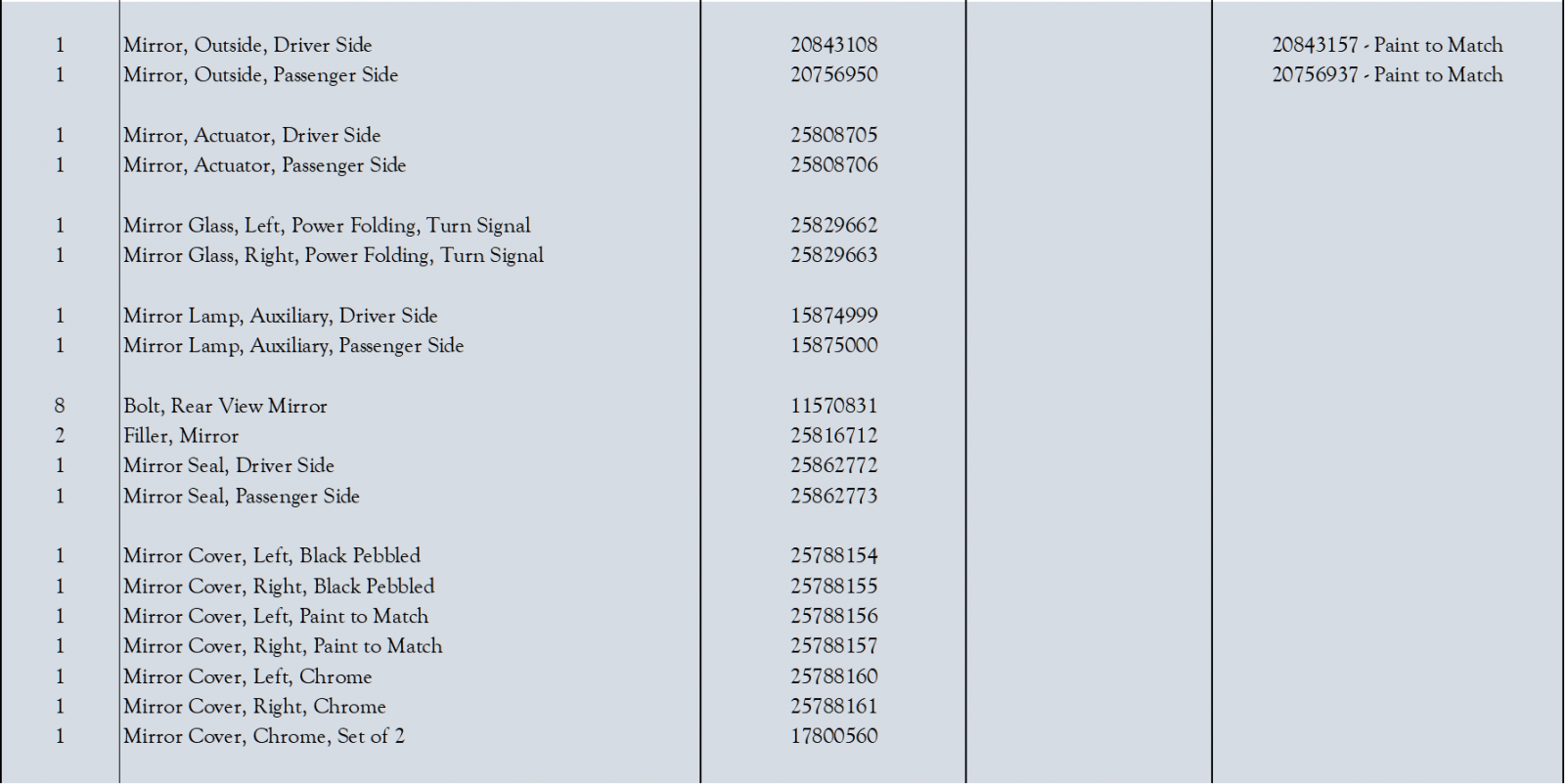

I have a 2010 Tahoe LTZ with heated mirrors, LED signal and autodimming driver side..the driver side is starting to brown, which is telling me the auto dim is leaking..is there any replacements? i cant seem to find any.
Also..my passenger side folding motor decided to break..cant seem to find a replacement..tempted to buy the motor upgarade...any suggestions?

I got my replacement on Amazon. They usually have black caps but you can switch yours out. I think I got my folding mirror rebuild kit at Gruvenparts.com. The plastic gears in the stock mirrors break. They also have complete mirrors.
