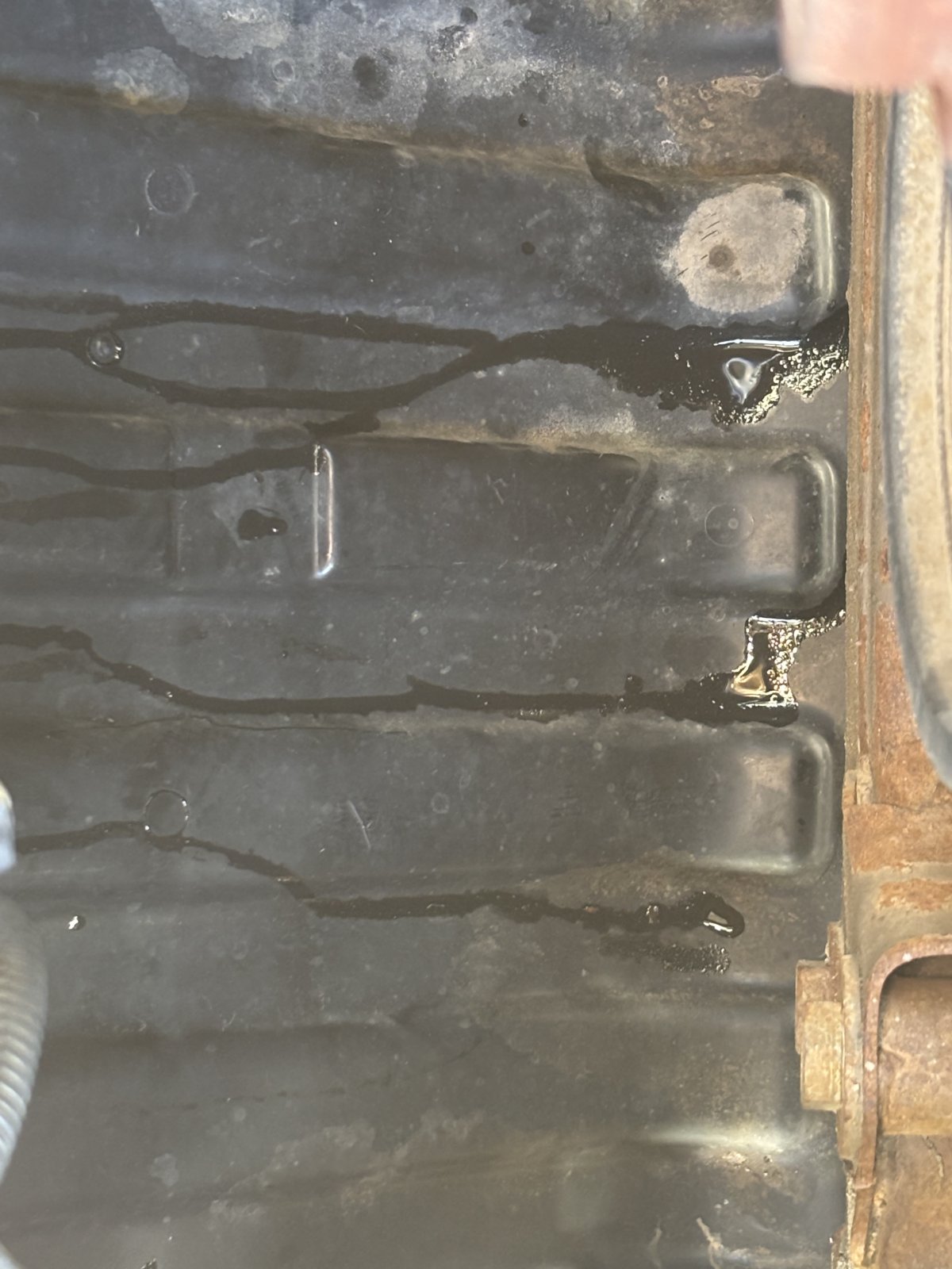

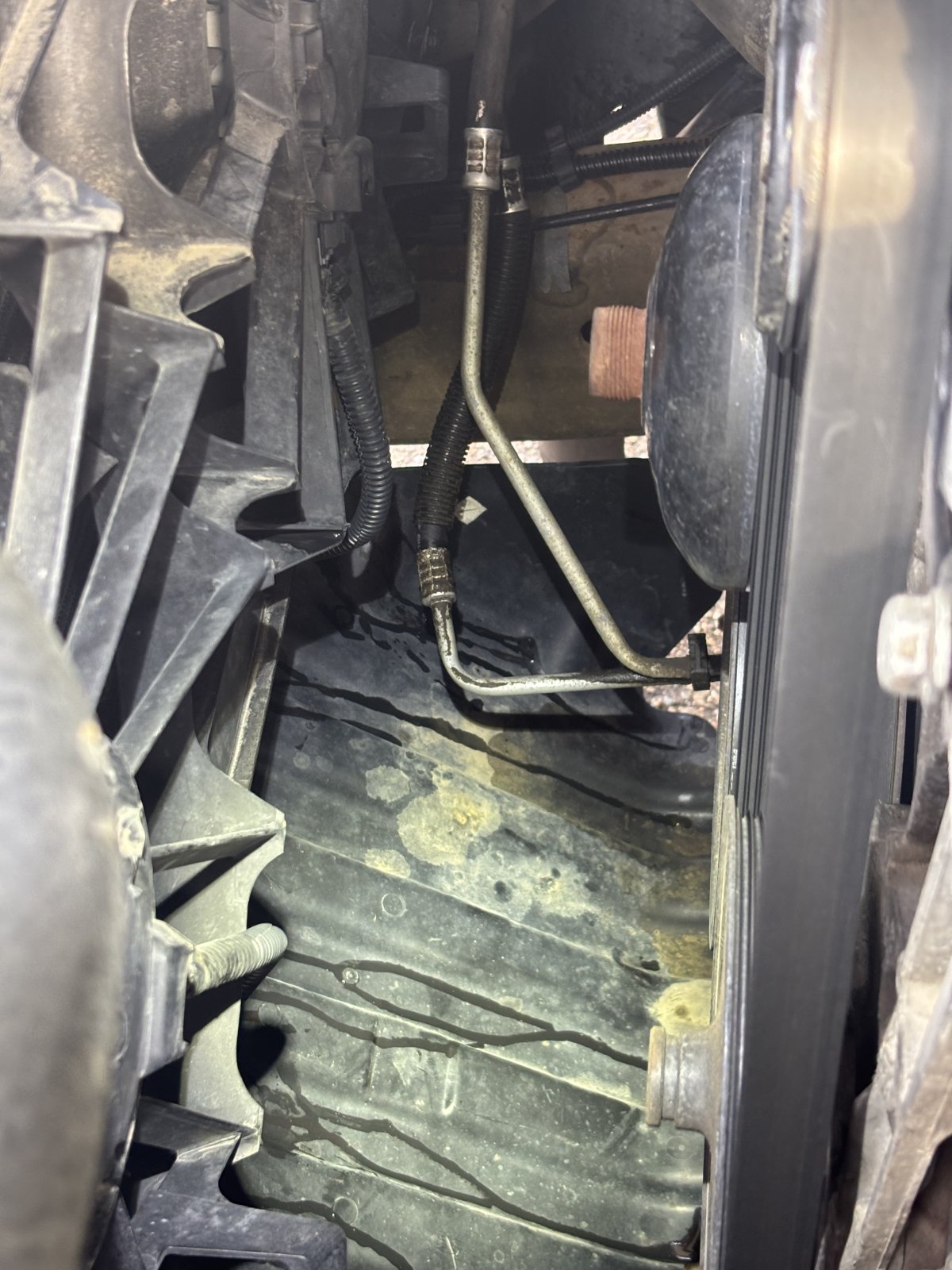

Need support. Just found out my radiator is leaking

Have you checked drain petcock to make sure its tight and if is check Oring on petcock.

I doubt there is one; if there is it will be near the bottom of the radiator on the driver's side. Not having one probably saved $0.50 so worth it to GM.

I had a three year old Acura radiator spring a leak. It was nothing to drain and take it out and to a radiator repair shop. It was no big deal and didn't cost much *at the time). They boiled it out, soldered the leak and pressure tested it.
Honestly the hardest part was draining and containing the fluid avoiding contaminating the area but it worked out well.
Ours aren’t repairable. They always leak where the plastic end tanks are attached (glued?) to the aluminum core. It’s super unlikely one leaks in the core where it could even possibly be welded. Better to just buy a new one.

The year truck we are dealing with in this thread doesn't seem to have a drain plug but my 2002 Yukon has one on drivers' side and has a hose on petcock to get fluid by frame horn to drain pan and my 2017 Yukon has one on passenger side but is pain to get to.
