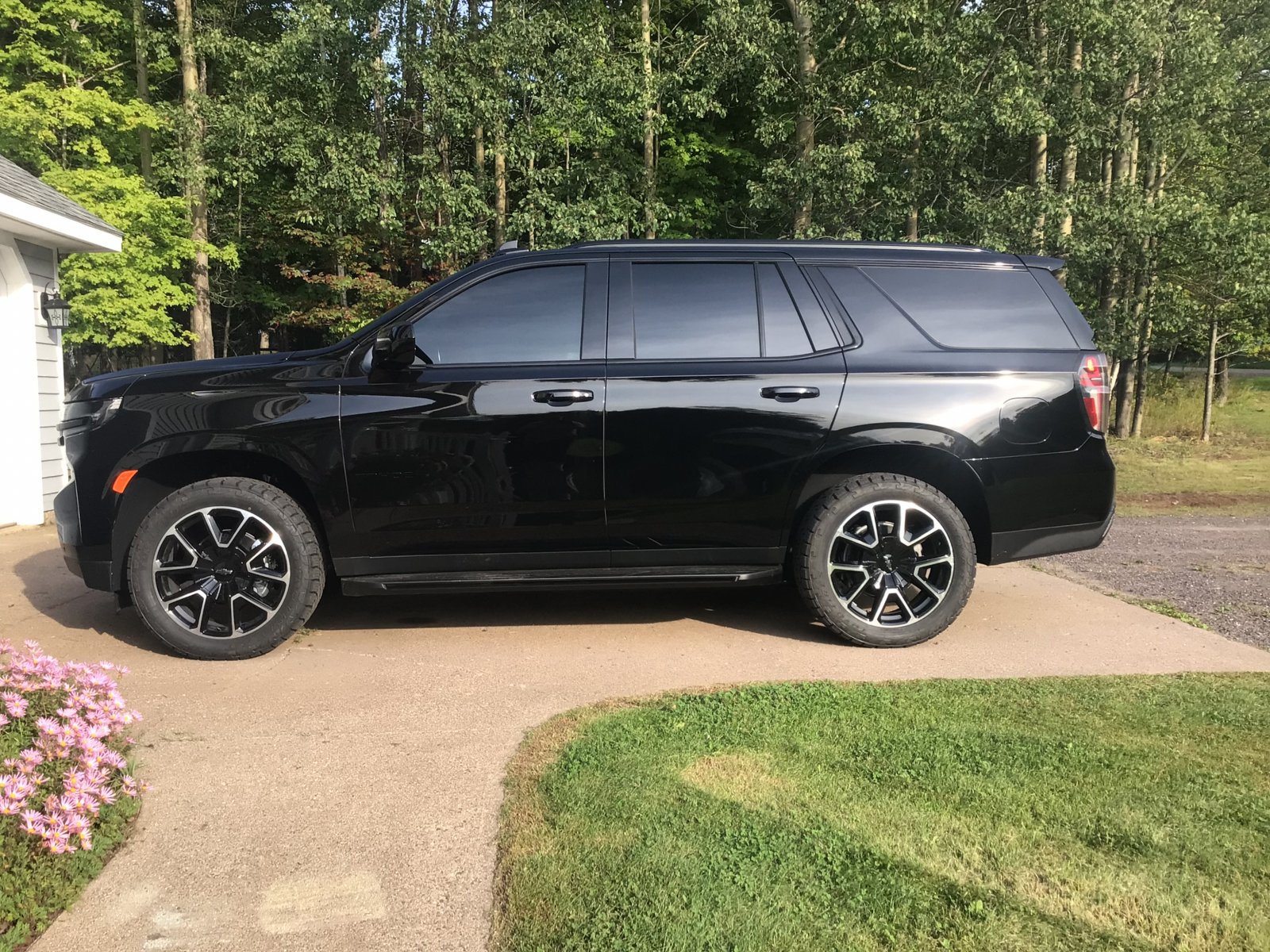

Pics of the truck, please.

I would really love to find an alternate size that does not rub. Anybody here have any first hand experience with the factory 22 inch wheels and different rubber? Pictures coming tonite. It is black,black leather interior.
