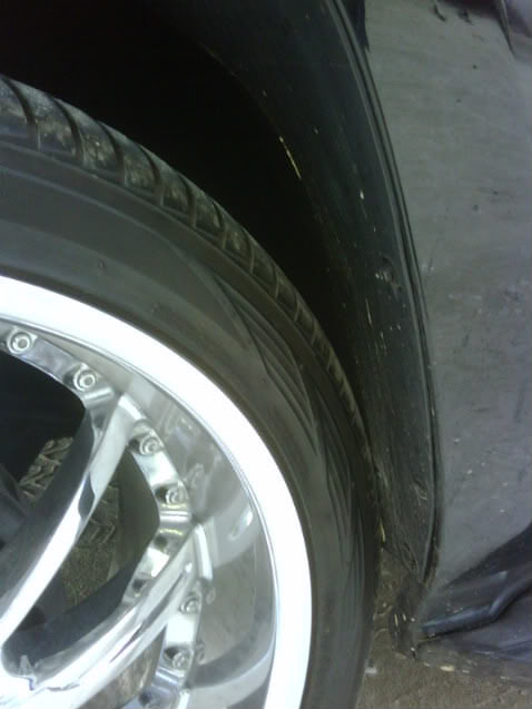

mind elaborating on the BS? because I wanna make a decision soon and im still stuck in between the bags and regular 2/3"
as for the rubbing, its when turning the wheel to the extreme left or right. do you guys just let it be and fix itself, or is there anything u do?
Front
And back..

I'd like to get a kit like this from Universal Air Suspension... https://www.universalairsuspension.com/store/product_info.php?products_id=227
My tires are a little bigger than yours but I've had to do some heating/cutting on the plastic wheelwell liner, and once the lowering kit was installed a rubber mallet was used to slightly bend back the inner most tip of the front fender behind the front tires to prevent rubbing.

Rims make a night and day difference for appearance. Ride it out for a few days and see if the natural rubbing wears out the parts it rubs, so it won't rub anymore. Thats what I did. If that doesn't take care of it or you prefer not to wait, you can get a heat gun like iwaslowr said and slightly melt/mold the plastic away were it rubs.

How did the rubbing end up? did you just ride it out or did you take a heat gun to the plastic?
