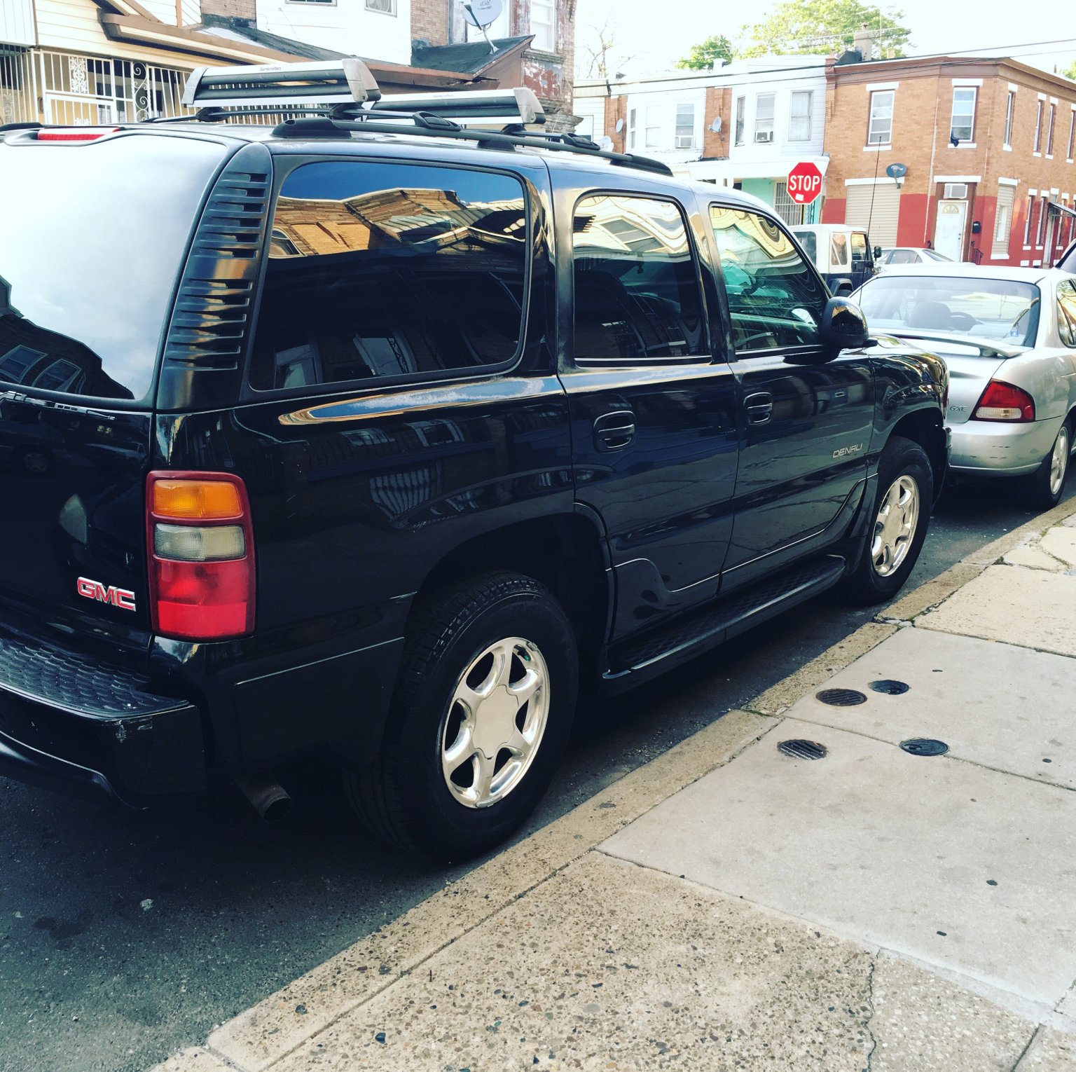

Just picked up this clean Denali has a few issues
1. Service air bag light on
2. Steering wheel controls don't work none
3. The trucks goes to reduced engine power after driving for a while and no check engine light
4. When driving or taking off a little hard you hear a loud clunk sound or even when coasting and hitting the gas again it'll clunk loud

They'll look good next to each other right now, how about a side-by-side shot?
No problem will upload a few different angle pictures this afternoon. Just have to get out the house and take some lol I'm thinking of putting 22 esky stocks on the black one to I have a extra set just have to put them on
