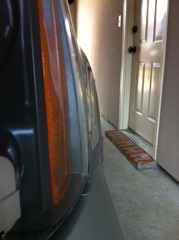

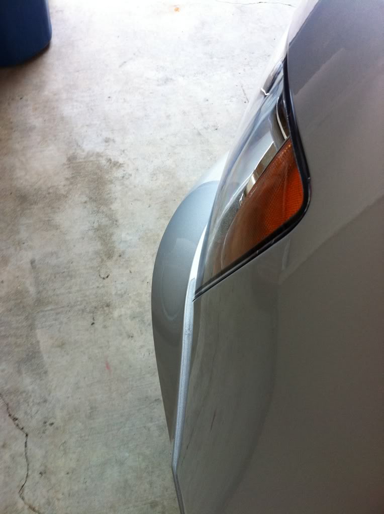

Only complaint I have is that the front bumper cover and fender don't line up perfect like the other side (Left to Right). I can push it back in and it is flush but if I drive it it comes back out about a 1/8 of an inch( between the headlight and the fender well where they meet, it will shift over). I have looked behind the fender well liner and pulled the bumper out and I see where it has two circular slots but it mounts to nothing when you slide it back in. I tried to adjust it and it is better than before but not flush like the passengers side. Has anyone had this issue and know how to fix it? I know I can bring it to the dealership but I was thinking it should be an easy fix and DIMS.

the silver is so bright I hope it shows up. If you are standing over the fender looking down, the bumper would make it look like an over bite.

Mmm yeah that's not right ...
Only thing I'm aware of that would do that is either a missing/broken tab or a defective (malformed) bumper. Either way make the dealer fix it because it's defective. Even if you could fix it yourself I would advise against it ... don't give them an excuse to claim that you did it by messing with it.
