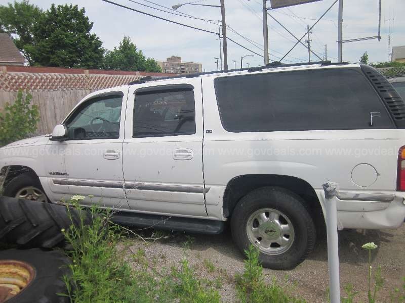

Hey all new to the forum. Playing around on the auction sites I ended up buying an 01 Yukon XL last week lol. I'm hopefully picking it up in the next few days here. Paid a grand for it. There wasn't much in terms of description, so it was like a $1000 lottery ticket. Well, I think I got burned. But regardless, it's mine now. So I'm gonna make the best of it! Here's what I bought it based off of seeing haha. I don't think it looks too bad... :badidea:
yukon1.JPG yukon2.JPG yukon3.JPGIt's a white 2wd SLE.. Living in northern Ohio, I'd much rather have had a 4x4 but it is what it is! I know a good set of tires and common sense will get me where I need to go. I haven't used the 4x4 in my explorer or WJ yet, and I'm very good at bad weather driving.

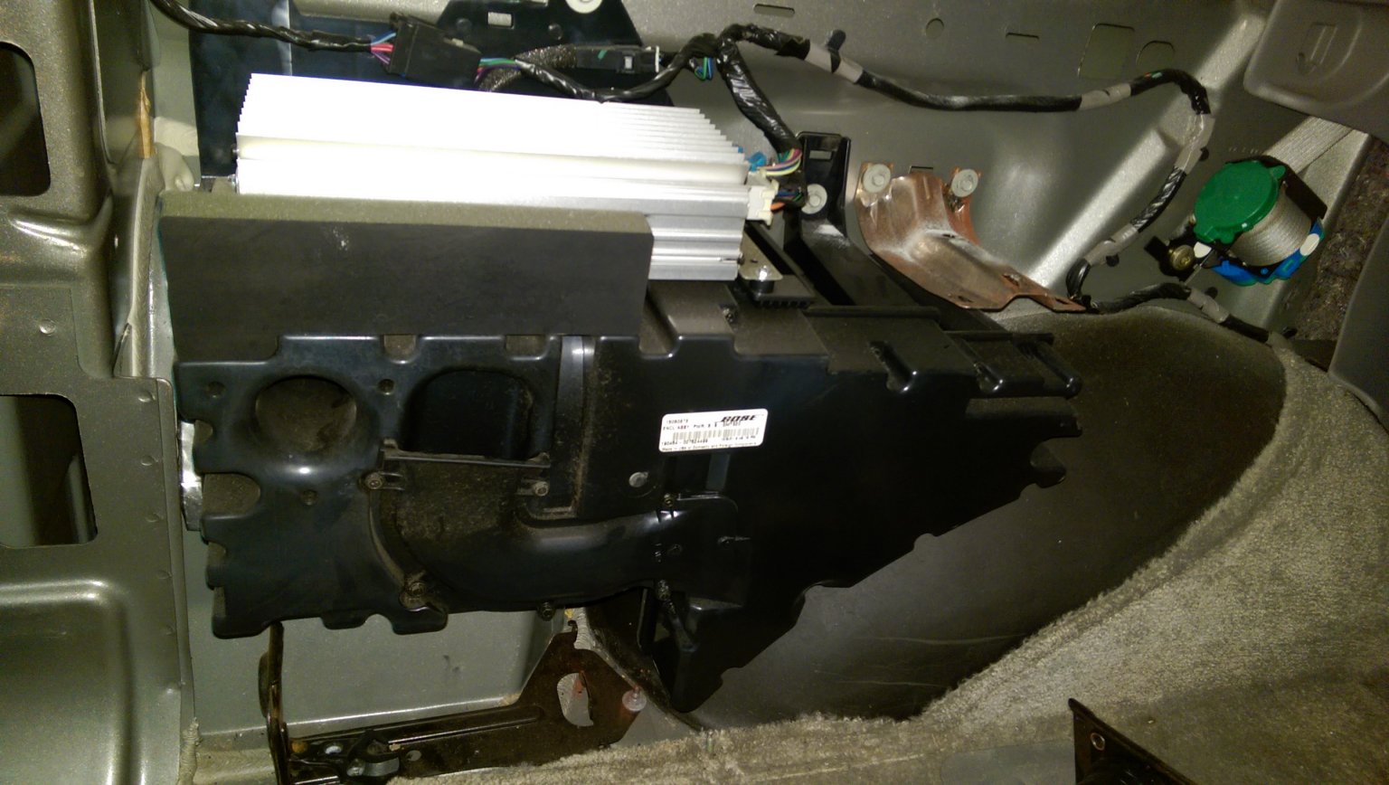

Don't know a lot about these subs, but there are 4 of these Soundstream SPL 12's in a big ol box back here. 3 were pulled out, I'm guessing to check for drugs hahaha. Also found this American Bass door speaker on the passenger side. I'm guessing they all are. Pretty cool. I used to be into this stuff back when I was younger. But never listened to the right music for it (metalhead here lol).IMG_2951.JPG IMG_2957.JPG

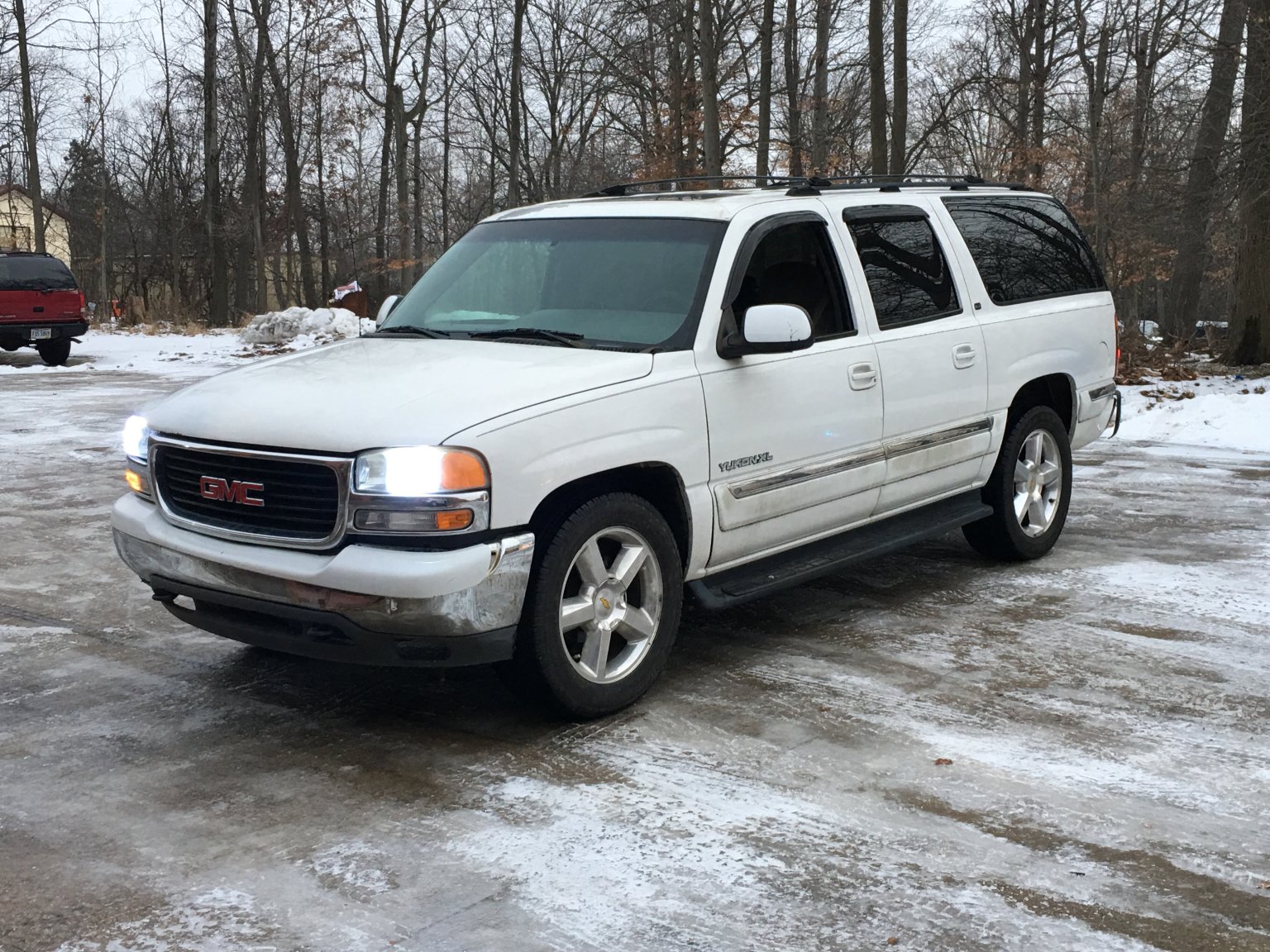

And just a random I took of it when I got back from trying to get it to do a burnout today LOL. My shop is in an industrial parkway, and theres a deadend road to nowhere that I use for testing my cars out to see how they're running or to see what's wrong with them. I was disappointed when it only chirped the tires and then ran hahahaha...
