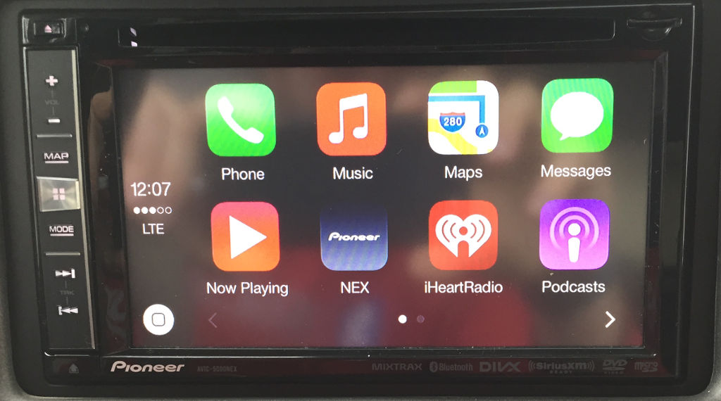

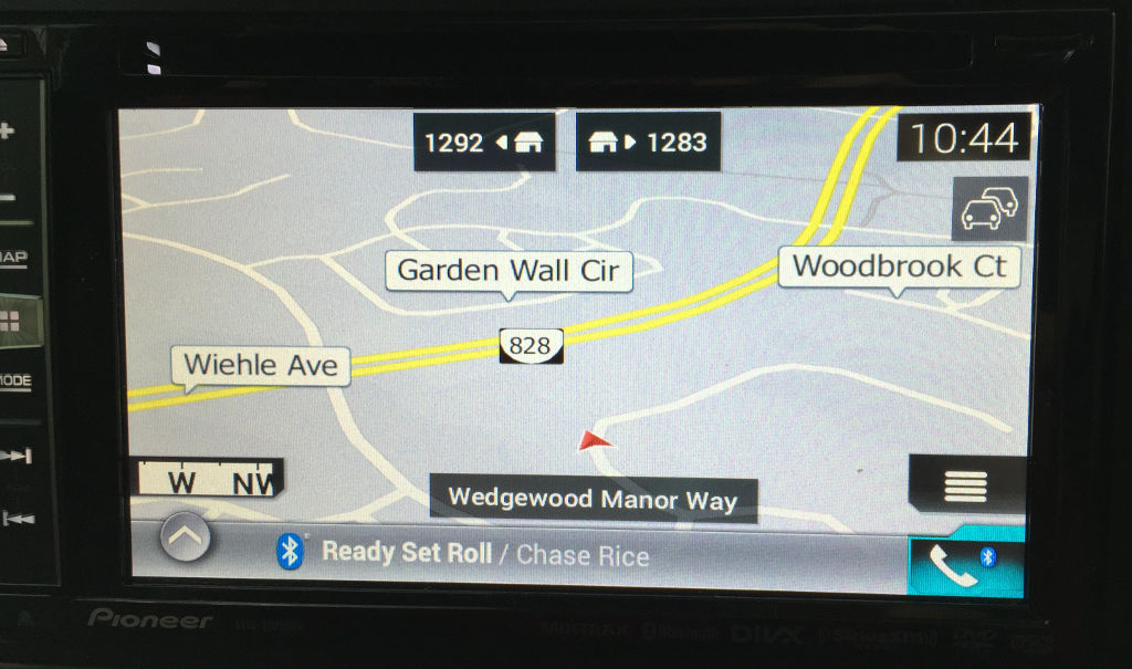

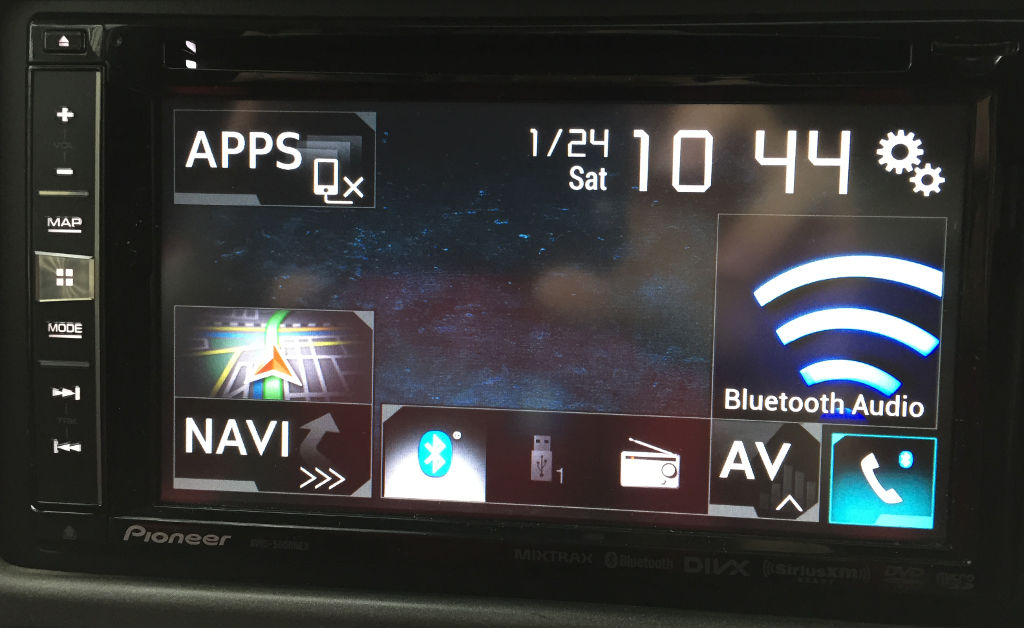

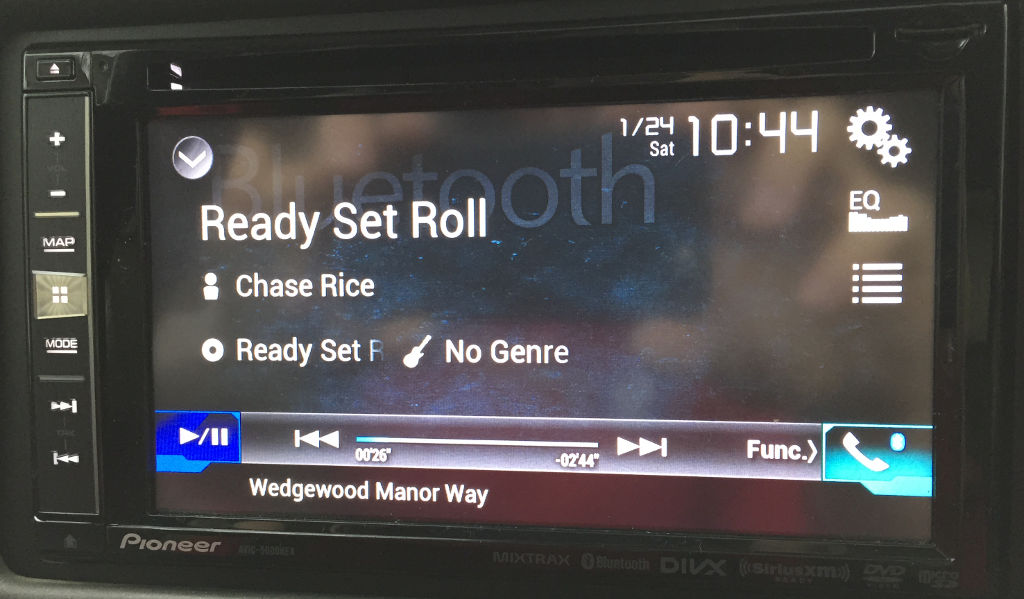

Pix of the new H/U - love it so far. Was $499 from Sonic.
