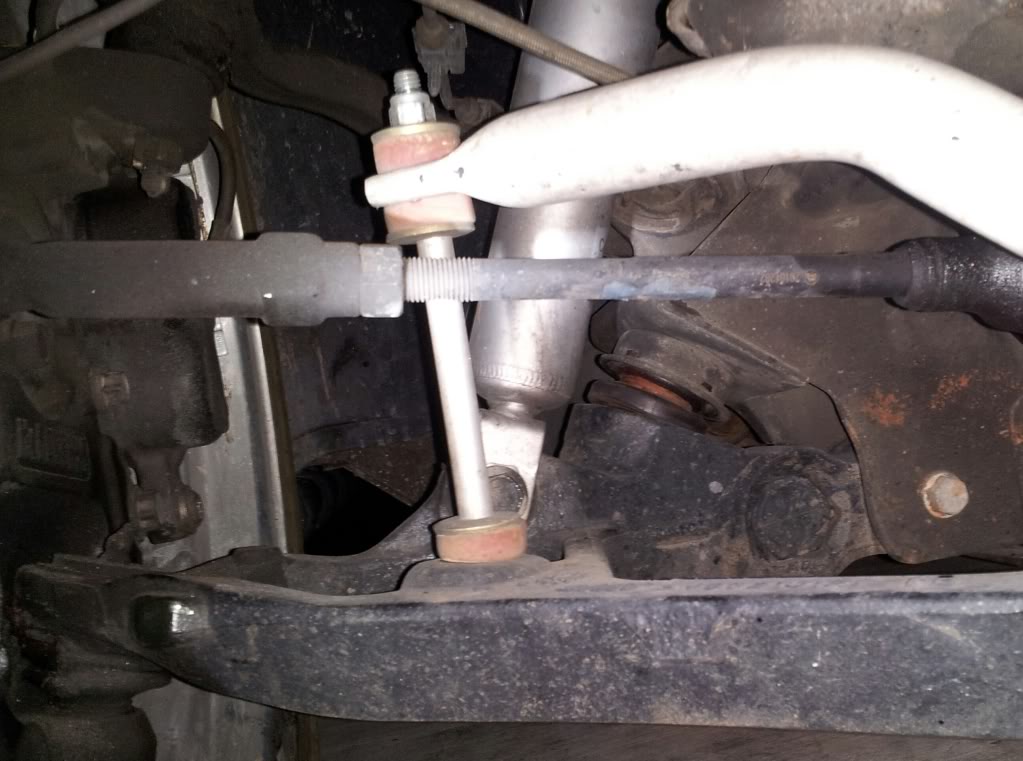

This is pictures I took of the driver and passenger side, the drivers side is the one that's pushing that black rubber thing down.
Drivers side
Passenger

First, it definitely looks lowered because those arms look like they are basically laying on your bump stops (the black rubber things)
That could cause a lot of bump steer and other issues your describing it with wondering around the road and riding harsh. Can you show us a pic of the entire truck? You can adjust the front back up a little by adjusting your torsion bar keys up front.

That is deffenantly lowered as looks like <1" of travel to the bumps.

It doesn't look or seem lowered?
I thought the bump stops were supposed to be touching the lower arm as part of the set up, no?
I just though because one was way more compressed than the other that it was an issue with one side.

damn, it really doesn't look lowered. there's definitely something wrong though because it looks like your suspension is resting on the bump stops so it has no travel when hitting any bumps or anything...

You have a suspension problem there should be more clearance between the bump stops and the control arms. basically as the other's have said somethin doesn't look right do you know the history of the truck ? Also take it to a good tire shop and they should be able to help you out. as far as the steering goes what is probably happening is that as your driving your Tahoe is hitting the bump stops all the time causing the stiff ride and also to steer funny.mine pulls to the left and has since day one my father's does the same thing and has since he has owned it both our 00 Tahoe's have been looked at and they havent found anything wrong . so your suspension needs to be looked at by either a good tire shop or a performance shop that does suspension work.

Man o Man. Would think most of you guys would know this by now! These torsion bar suspensions are SUPPOSED to use the jounce stops to give the torsion bar (a linear spring) a progressive rate feel. Why the fronts are called jounce stops, not bump stops. The suspension was designed to use them as a progressive rate dampener. So yes, they are supposed to be resting on them, and using them. Not ideal, IMO, but what GM gave us.
I would say your main issue is they are tore up. I have rode without front jounce stops before, and it doesn't ride very well. I would look into replacing those. Z71 jounce stops have worked very well for me and others. Also check your shocks. They could be bad, causing issue with ride.
