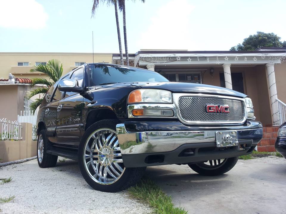

Hey guys, newbie here from Miami. Just purchased a 2002 Yukon SLT with 99,000 miles. Believe it or not I got it for $3,700. Former owner couldn't deal with the fuel consumption & leased a Hyundai. Go figure. Exterior definitely has issues. All the moldings are done. They are all cooked from the sun. In fact I'm already in the process of removing them. I will leave the car without any moldings for the time being. I think it looks better without them anyway. Paint is very glossy but the clear coat is pealing in a couple spots. The roof is completely faded. I will get the roof painted next month. The interior is in very good condition. It just needs a good cleaning.
Anyway, this will become my wife's daily driver in a couple weeks. Until then, there are a couple things I'd like to learn about the truck. There are fog light holes where the fog lights are supposed to go. The fog lights button works, it turns on/off. Am I to assume the SLT brought fog lights from factory? I'm removing all the chrome accents from the truck including the 22 inch wheels w/new tires. I'm selling the wheels w/tires for $1,000 firm. The rest of the chrome accents I'm tossing.
I'd like to trade my wheels for 2007-2012 OEM Tahoe wheels.
Also, I have noticed the RPM's on the truck are below 600 when the truck is idling. Is that normal?
Last but not least, I discovered there's a sub woofer in the driver's side rear of the truck. It is not working. In fact the entire stereo sounds worst than a 1986 Atari system, lol. Where is the amp located?
This is my new baby!
