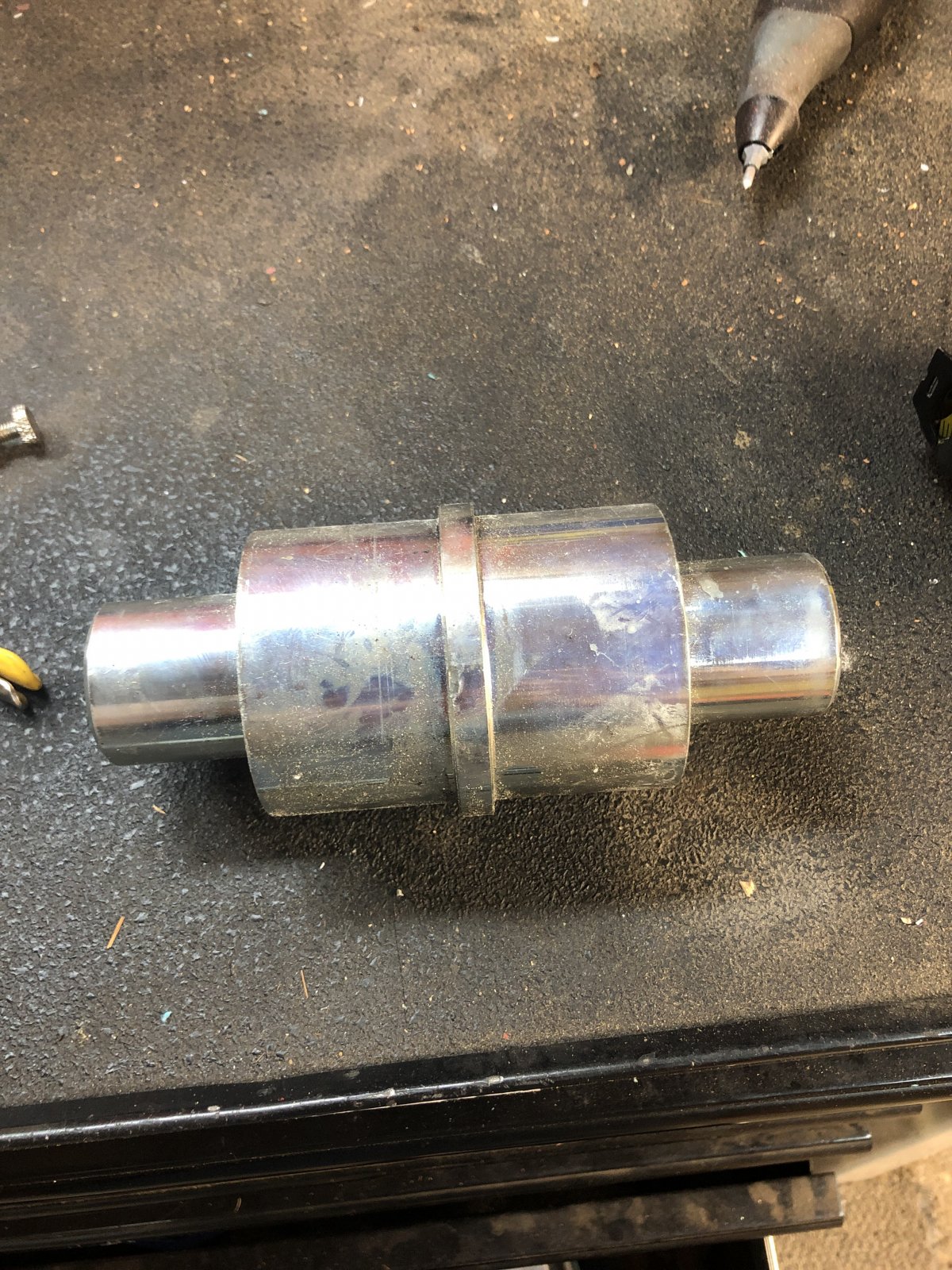

Weird, the bearing puller and install set I borrowed from Oreilly worked perfect.
PatDTN
PatDTN
Jul 5, 2016
602
424
Probably. I now see them as the better auto parts store. I got my set from AutoZone.
