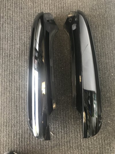

D Pillar Trim
Found a set of black Escalade D Pillar Trim pieces on eBay. They were in good shape with all the clips in place. The clear coat was starting to peel near the edges so I took them to the paint shop to have repainted when they paint the Tahoe. (pic)

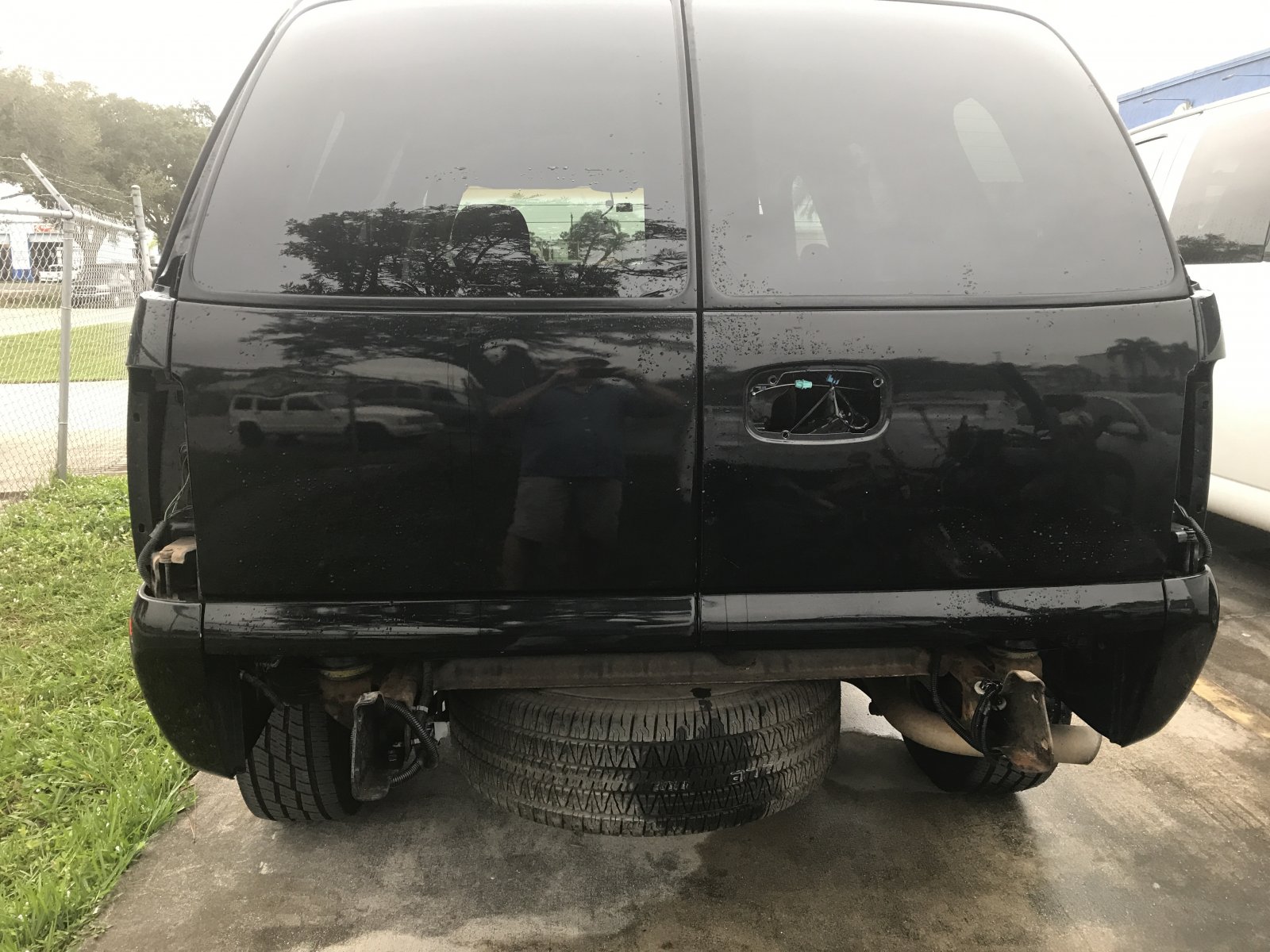

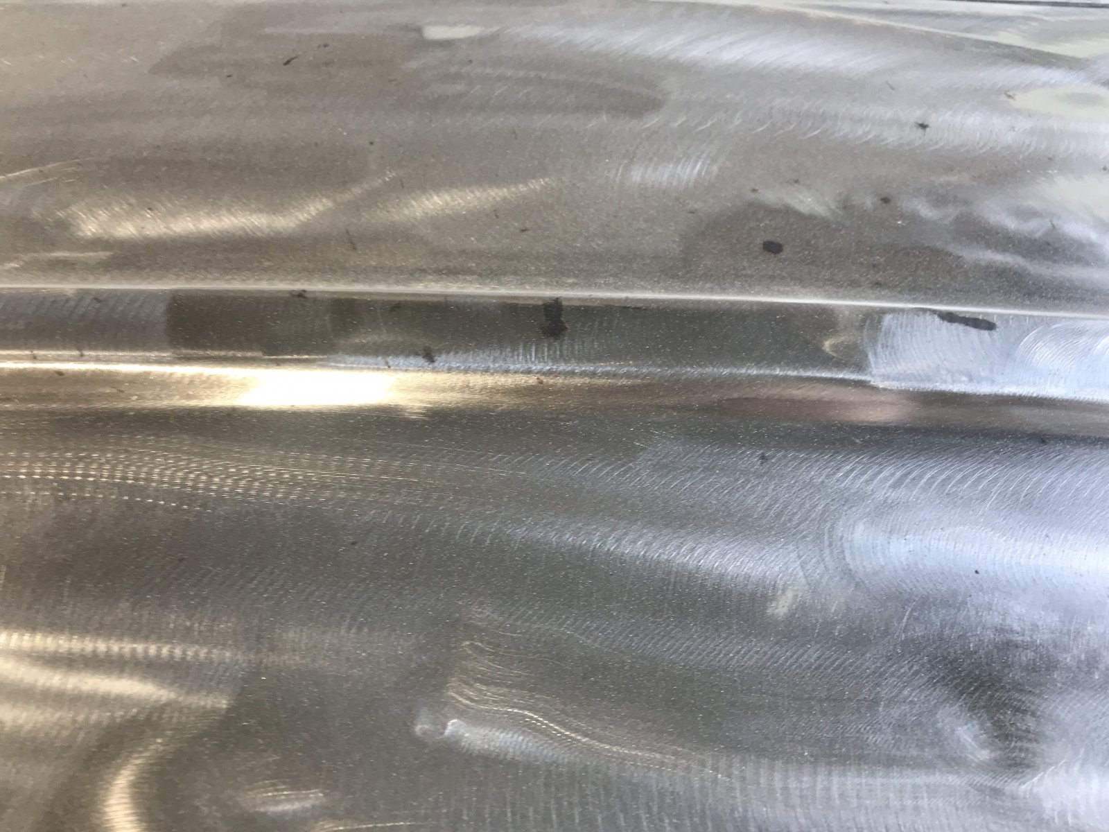

Took some pics at the body shop. Notice the tan spots on the roof (1st pic). It's not flaky rust like the ones on the surface. They said it's imbeded rust in the metal. They will probably bubble up in the future. It may take 1 year or may last 10 years. Options - 1. Chase all of them through and make patch repairs. 2. Replace the entire roof or 3. Epoxy over them and see how long they last. Option 1 & 2 are way too expensive. We're going with 3 and will just have to do spot repairs if they surface.

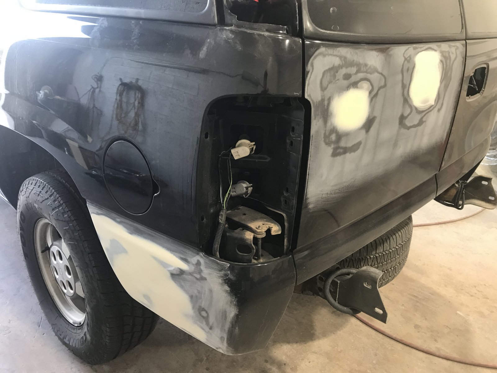

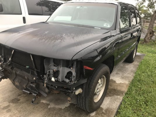

Visited the shop today. Pics of progress.

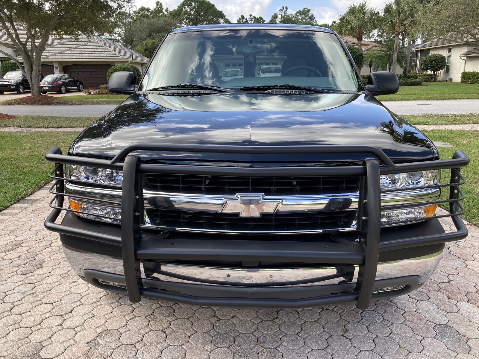

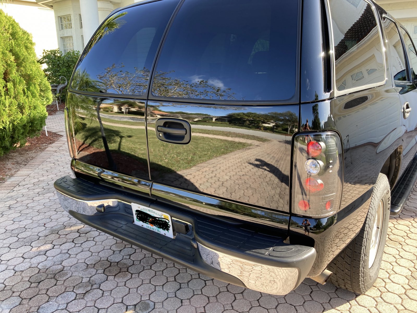

It's painted and back together! I'm pretty happy. Every exterior light has been replaced down to tag lights. Next, will be some inside improvements like a head unit with back up camera and car play.
