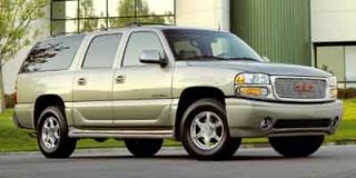

Chances are good I'll be trading my truck for one coming up shortly.
It has 170k miles which isn't too bad for an '03. Still looks pretty good.
Looks like this:
I am in CA so rust is not a concern really.
