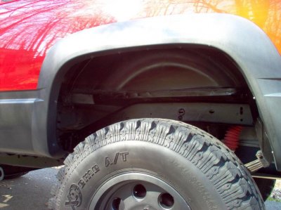

welcome. I'll also say remove the molding, stickers, emblems and all that. Paint the frame and wheel wells after a good cleaning.
post some pics too.

already removed emblems. still debating on removing the moldings. what do you recommend for painting the frame and wheel wells? flat black or semi gloss black? what brand paint?
is a leveling kit worth while? not really wanting to do a full on suspension lift just yet.

All 3 of my trucks I've use a cheap frame paint from an automotive store or hardware store. Wisconsin winters are brutal on frames, so the paint will chip away anyways. I just go over it good once in spring, and once in the fall.
I do have some POR-15 stuff I've been wanting to use. Maybe this year before snow fall I will try it out.
The leveling kits for the OBS trucks are really not worth it. You are better off just saving up for a lift kit if that's what you want to do. All the leveling kits for these trucks are is just a expensive way of cranking your factory key's up

X2 on all this , iand as for the type of paint i just use a flat black i wouldnt use gloss or anything
