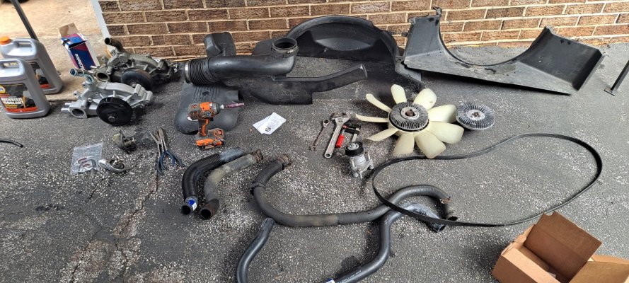

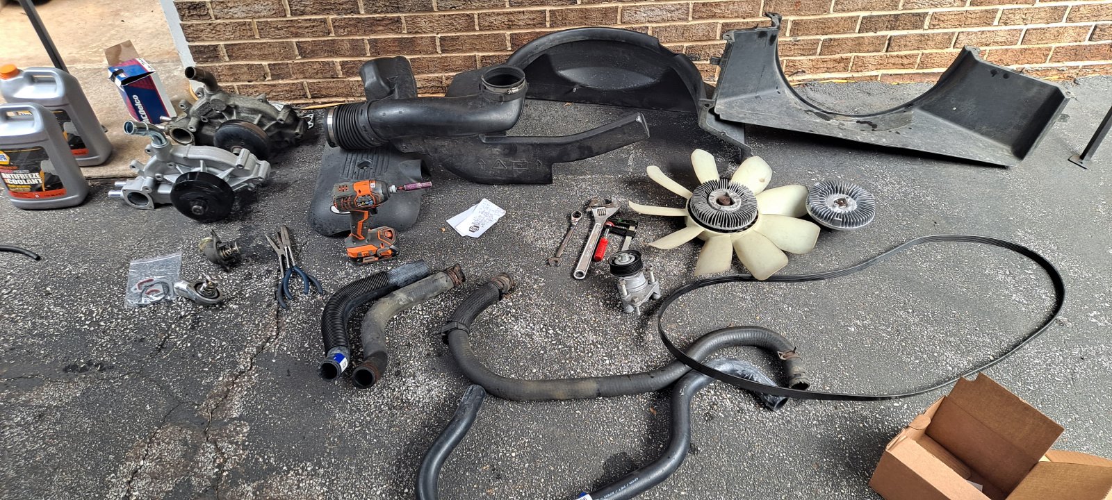

Got it finished in about 2 hours. Also replaced upper and lower radiator hoses and T-stat. The fan clutch roars about the same as my old one, a little bit longer just while.cold in neighborhood. Nice and quiet now, old pump bearings were very rough and the orange antifreeze was very brown.

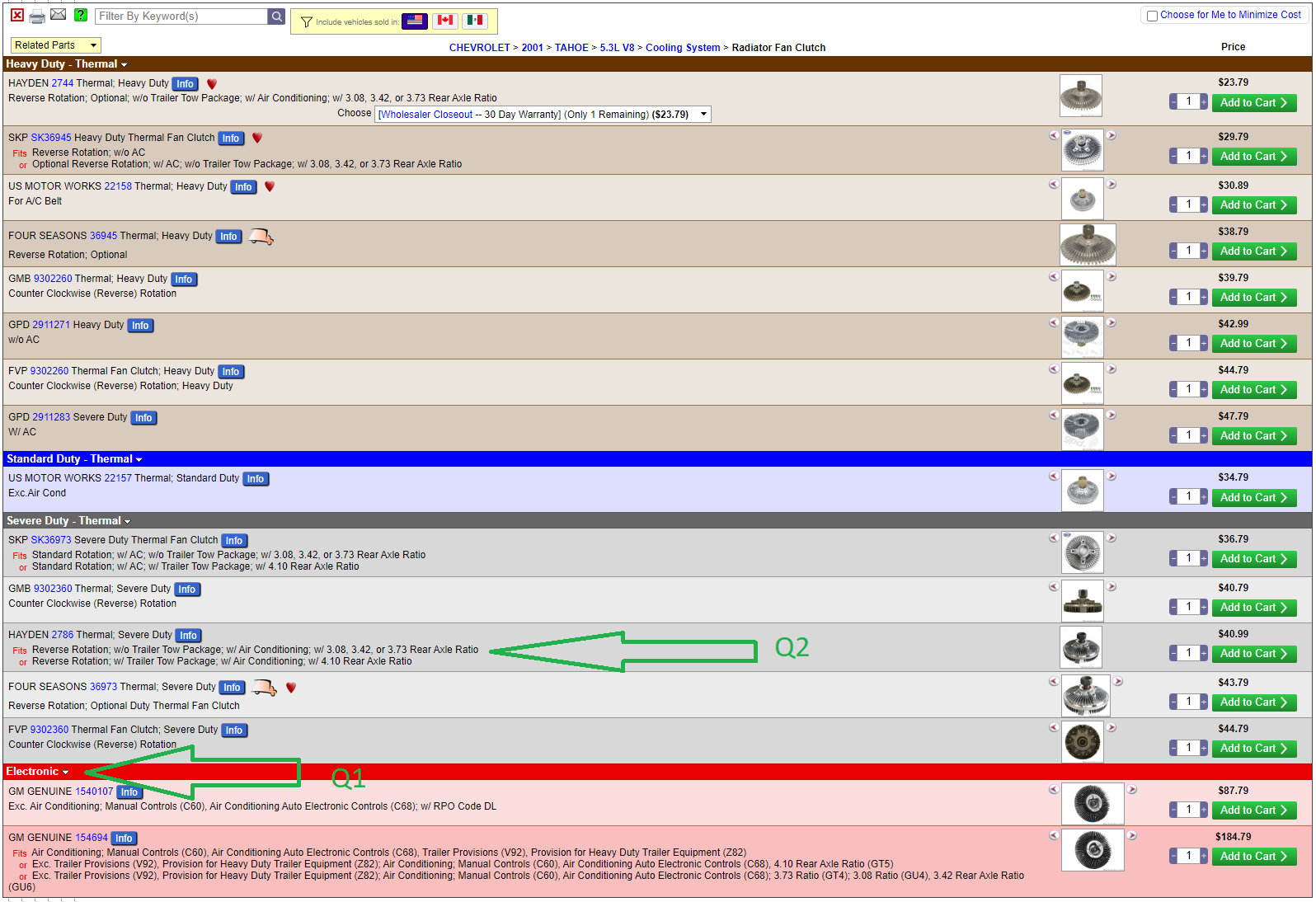

I have 260,000 miles with original clutch hub. I noticed off road that my transmission got a bit hot... still well under 200F but I didn't like what I saw. The guy riding with me built these trucks for a living (retired from GM assembly line). He suspected the clutch hub as you could never hear that gust of air coming from the fan. I figured, probably wouldn't hurt to get a new hub.
I'm sitting here confused about codes on Rock Auto as well though. I think the same clutch hub will fit mine Q2 below... I want to make sure I get enough cooling though as I built up a 6.0L and dropped it into my 2001 Tahoe. I assume, the main difference between these is the thermostat to activate the clutch and rotation direction?
My next question is what the heck is an electronic clutch hub (Q1 below)????? Isn't that a bit of an oxymoron... is that a mistake on rock auto? I don't know if I have to buy one of the OEM ones because they are the only electronic ones? What is that?

I can't answer anything on part specs. for this.
As far as brand goes... I put a Hayden on my Jeep 4.0L. They were very highly rated by the members in the forum. No issues. Good quality part. If it is the correct one, go the HD for a couple extra dollars.
Keep in mind, HD fan clutches usually spin faster and stay on longer. They can make more noise than a SD clutch. Some describe it to be a "roar" or "like a jet". Definitely more truck-like...
But that would be the trade-off, if you really need the maximum cooling of an HD/Severe Duty fan pulling more air through.
SD clutches tend to be more quiet.
