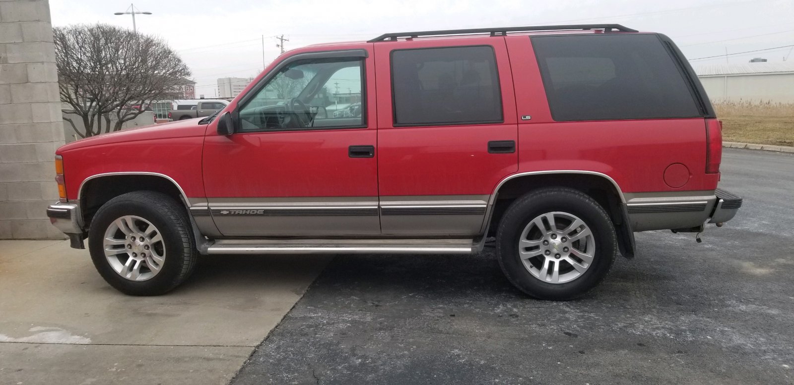

I have a 98 Two Door 4x4 at stock height. See photo. I got a set of OEM stock brand new factory 2018 Silverado wheels & tires (Goodyear Wrangler P265/65R18) from a local dealer as take off's when one of their customers wanted custom wheels. They fit and drive great. Hope this info helps. Bob

Very nice, they look beautiful on yours.
Thanks for the help on this. You all have been a big help. I hope I can contribute info one day.
