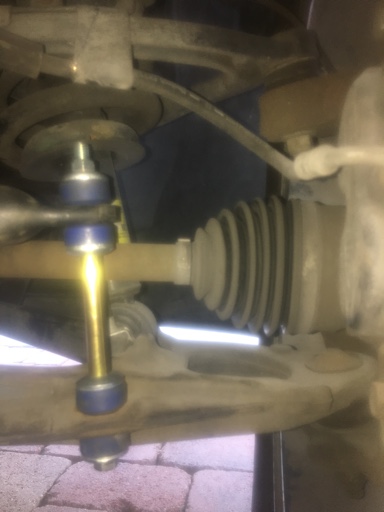

Just replaced the oem sway bar end links with blue poly inserts. Oh yea! It doesn’t feel like you’ve gotta reach for the oh shit handles before going into a turn anymore. This is a permanent fix as the poly won’t crush, breakdown or disintegrate from engine / road grime.
