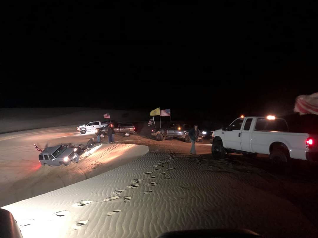

What's up boys? I have a problem. I have a 00 obs Yukon Denali. I put the pin hole in my first transfer case. I picked one up that was rebuilt 2 years ago( end of 2017), from Jasper engines and trans, but I found it in a escalade at my junk yard. Anyways I put it in and my 4 wheel drive worked again, and since it was a rebuild it was fixed as to not get the infamous pinhole leak. I thought it was going to be perfect. I took it to the sand and sure enough, 2 hi, 4 hi, 4 lo, all worked great. Or so I thought. Turns out that if I get into a sticky situation and need to back out, my truck decides it's only 2wd again. And I mean leaving it in 4 Lo, and selecting reverse, only rear axle spins. Same with 4 hi. It's a push button transfer that I'm probably going to ditch the push button for a DIY manual selector. The t case selector is electronic controlled, but you can move it manually if you do some work, but the transfer case itself is vacuum operated. Would a vacuum leak or something be causing reverse to malfunction? I got stuck 3 separate times last night in the sand because of this. It seems to be a pretty rare problem, and nobody has been of any help. So I'm bringing my problems to you guys. What do you think it could be? Any help is fully appreciated. Thank you guys.
