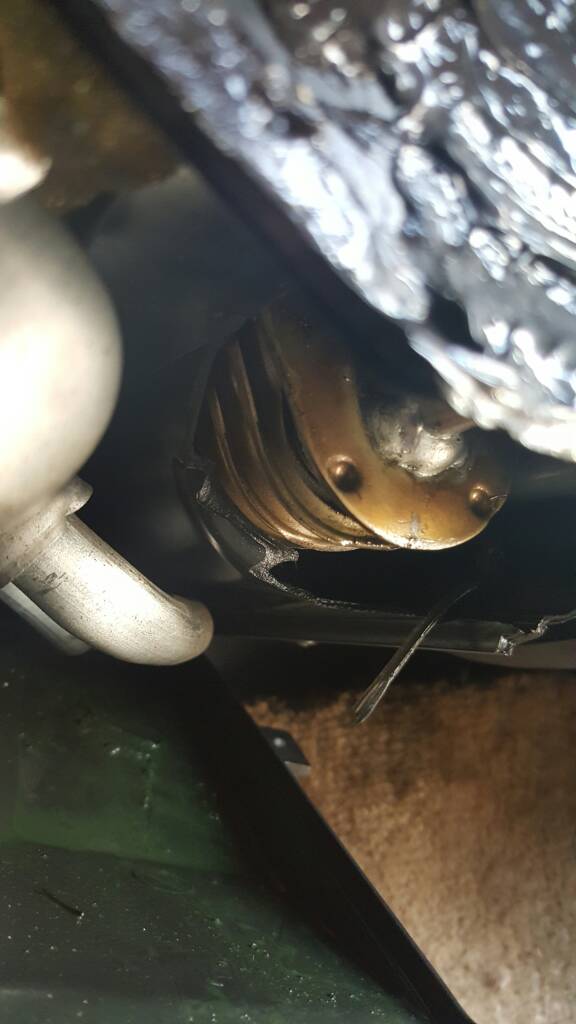

Well turns out the problem is I have a hole in the plastic box and the ac condenser is busted up also :(
I filled it with foam as a temp fix, so the hot air doesn't escape.
Fixing the condenser is a big job am I right?
yes the a/c system needs to be discharged and the hvac assembly completely removed if you actually mean the evap in the same box. for the condenser in front of the radiator it is easier to get out.
