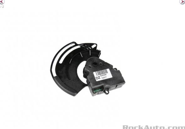

You know that actuator that's in the middle of your dash that's almost impossible to get to? That's your problem. And or the wiring harness going to it. Sometimes the wiring harness rubs against a sharp edge and that causes problems. Sometimes its the actuator. Sometimes its both! And I think the wiring harness also handles the ambient temperature sensor.
There's where I'd go after all you've done.
26,031
38,871
that actuator is for defrost, the hot/cold actuator is situated right at the blower motor output front and rear.

me neither, so just to clarify, if the actuator you are talking about was connected to a part like this in the photo below then that had nothing to do with hot or cold, that one is for which direction the air flows only
