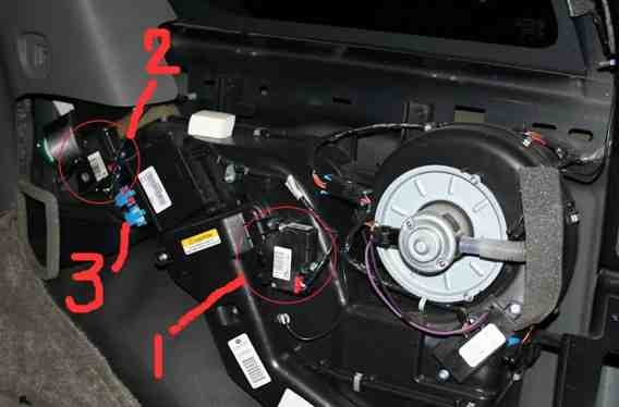

In my Denali I have two ways to control the rear heat. My overhead panel like you have up by the sunroof and a rear control for the rear passengers located on the back of the center console (not sure if the regular yukon is equipped with this). The actuator I needed to replace (which sounds like the one you need as well) is located in the rear cargo area on the passenger side. You have to remove the rear pillar trim, the trim where the seat belt is and the main wheel well cover. Once open you will see 2 actuators, it's the one in the middle of the whole heater unit. Ill try and dig up a pic I saw on here to give you a better visual. There is also a relearn process ill post as well.

Here is the pic of the rear heater. Number 1 is the actuator that was causing mine to constantly run cold. Again I just removed the 3 screws holding it on and manually turned the knob with my hand.
