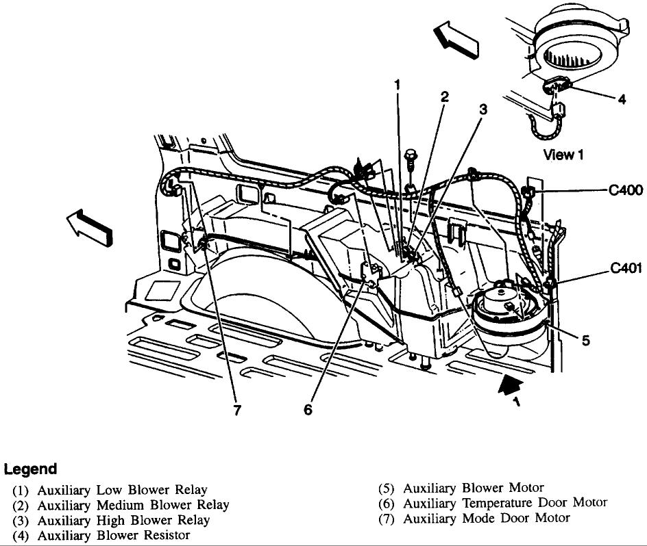

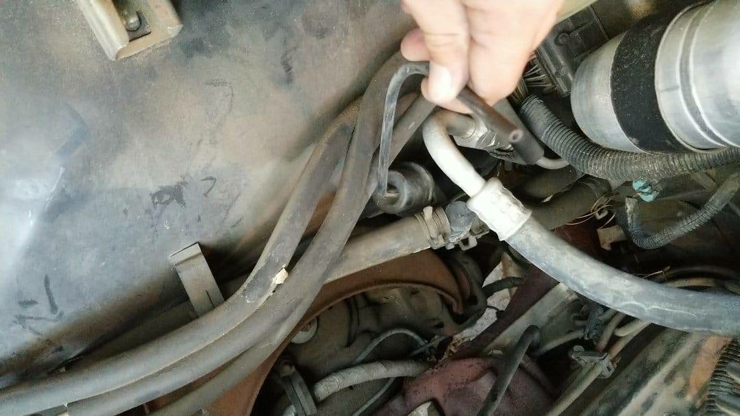

Hey guys, the rear heater won't blow hot in my 99 Tahoe. I removed the panel in the cargo area where the blower motor is and didn't find a blend door actuator in there. So I checked my heater control valve under the hood, and the vacuum line wasn't connected to the solenoid from the heater control valve. After I reconnected it, I tested the rear heater again and still no heat in the back. Perfect up front, but cold in the back. Any thoughts? is the solenoid bad? The heater control valve? Something else entirely?

Here you go. There's nothing else behind the panel on the left, either. The other pics are what I found at the heater control valve, and when I attached it back to the solenoid. 7bbc551e8f97ad793961374a9f09ca2e.jpgd381595e22758a7cdb4cca58e827281d.jpg24eb05c3a8b5cbba26b6a4f7a2784fd3.jpg

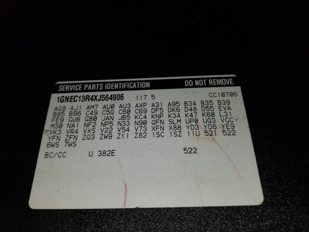

Do you have RPO code C69 (rear air) and/or C36 (rear heat)?

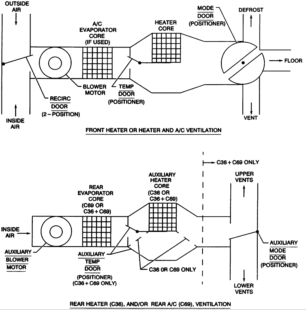

Here is the rear heat/air which has mode and temperature actuators that are controlled from the overhead panel.
That no door actuators are visible in your photo makes me think that there is either no heater core or at all or, at the least, you don't have both rear heat and rear a/c since there is no obvious way for air flow to be diverted from one core to the other.
Check the RPO label in the glovebox, see if those C36 and C69 are shown.

As for the water valve in your photo, it was provided on Tahoe and gas engine Suburbans to help with a/c performance. The solenoid is energized when the front a/c panel's temperature dial is set to the full cold detent. That then applies vacuum to the water valve, closing off the heater supply and return lines into the heater core to maximize a/c performance.
My two door Tahoe has it, and I have no rear air or heat.
Reach under the valve and you'll feel a small rod and plunger. It's spring loaded--push up and down on it.
When the solenoid is engaged, the plunger is up inside the chamber and two butterflies valves close the fitting's outlet ports--stopping coolant from entering the heater core. It circulates back at that point. When de-energized, it's out and the valve is open as shown in the photo above.
The valve only impacts heating performance when the temperature dial is set to the full cold detent, so it's not going to be your issue.

This. From your pic, i would guess you only have rear air, not heat.

Wow, EXCELLENT! Thank you for that! So in the RPO codes, I see C69 only. But it appears that there are heater hoses underneath. Pics to follow
