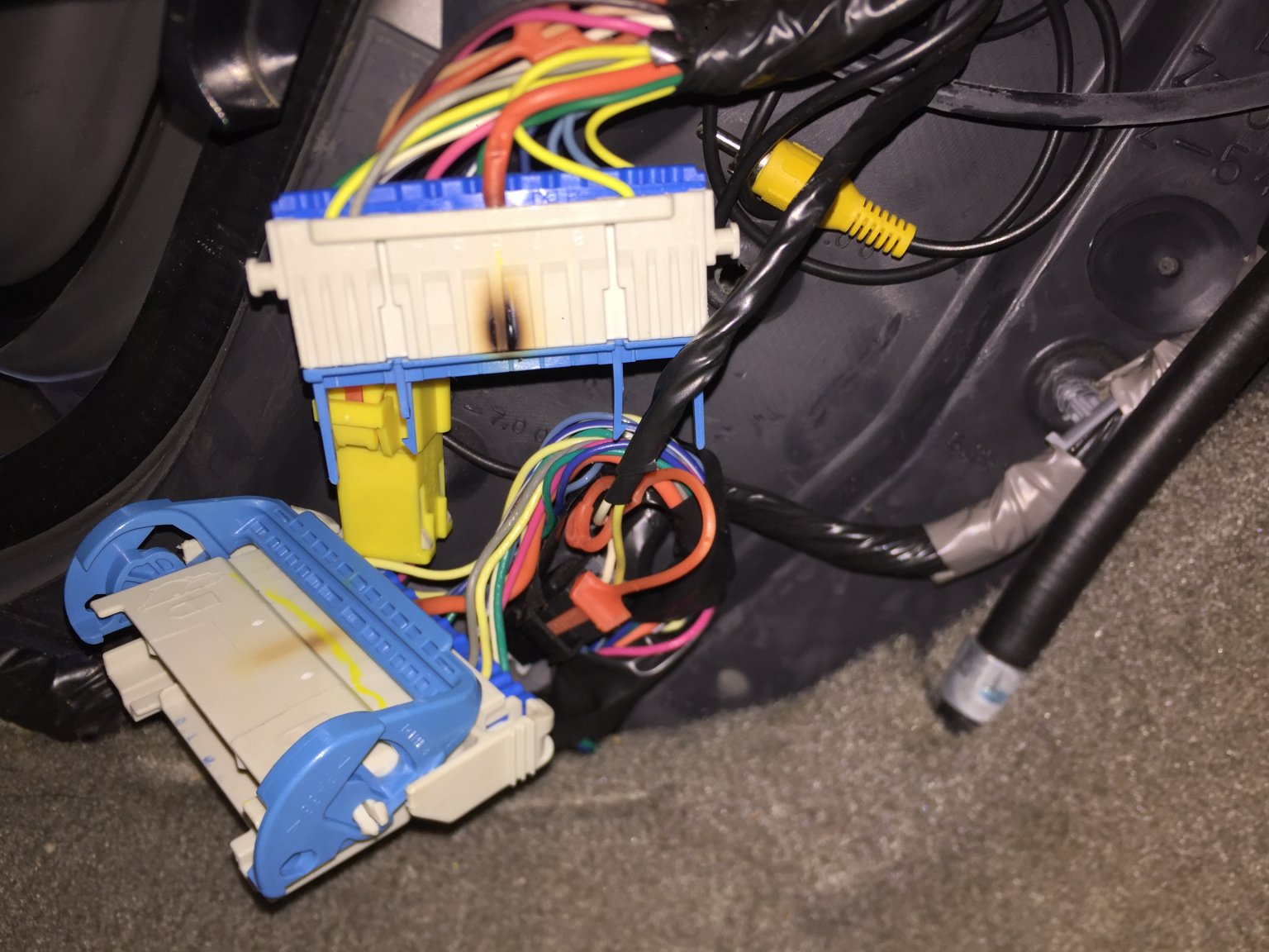

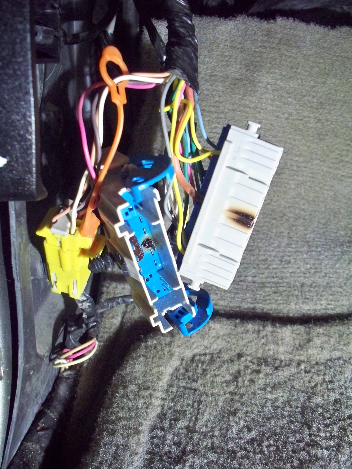

fejj
Feb 10, 2017
Glad I found this post!
I made the mistake in replacing the module in the rear which didn't work.
Then I found this forum.
Orange wire was the culprit! Mine is burnt or had been arching.
You can see the outside showing the light brown burn mark and on the 2nd image the connectors.
I did not replace but just squeezed back tight and working fine (for now).
Is this risky?
Red Rider
Dec 9, 2013
383
19
Looks like too much current going through the connection. or bad connectors? weird.
