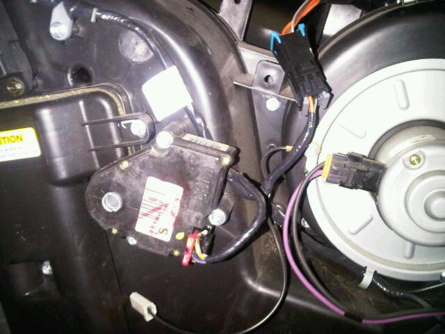

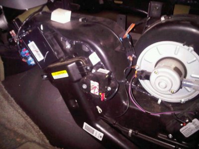

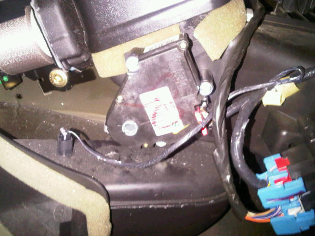

I had the same issue with no heat coming into the rear passenger seats and little blowing air. So I took off the panel and found 4 different modules. 2 look identical, 1st and 3rd, while the 2nd and last(closest to passenger door). I took the 1st one off, guess it's call the blend-door actuator, closed shut the louver inside, and voila, air.....however, it's still only blowing cold air. I tried everything up at the front console to get heat to it with the control knobs but "nada". Is there one of the other modules that actually give you the heat?
Pic 1 shows the whole rear hvac unit(the first blend-door actuator is hardly visible to the left of the square box-like module to the left of the pic). Pic 2 shows the 2st actuator(or third module), while pic 3 shows the 4th module(a smaller square box).
Anyone?
We've been pretty fortunate here with almost no snow in Toronto over the past month or so, and recently some mild weather over the past couple of days, so have had time to screw around. It'd be nice to fix it, kids were complaining a few weeks ago when it was freezing cold.
Thanks.

If I'm not mistaken, the blend door should control both hot and cold (hence "blend" - door). Try flipping that door to the opposite side and let me know what happens.
