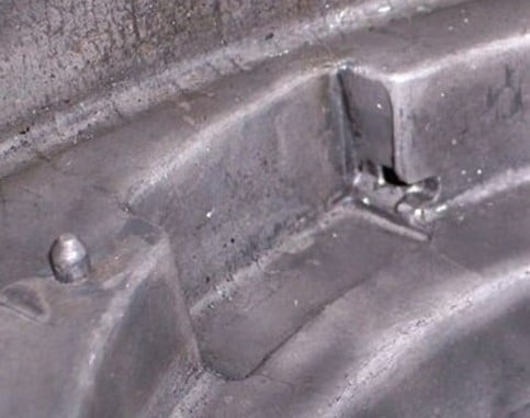

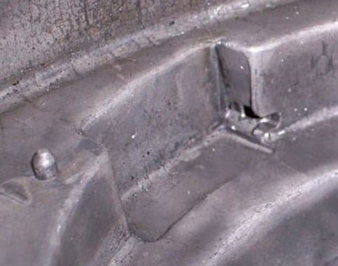

Just wanted to share my experience with y'all and hopefully save someone the headache of blowing up their transfer case. So I bought my '03 Tahoe about 6 months ago with only 69k miles. As of writing, I'm sitting at just over 74k. As long as I've owned it Ive heard a bit of a chatter sound from the front end. After inspecting, cv axles, wheel bearings, and driveshaft, I couldn't figure out where the noise was coming from, so I brushed it off. Well... After completing a 1500 mile round trip, that quiet chatter turned into a very loud, crunchy sounding chatter. Turns out the transfer case chewed itself up. The reason? The oil pump rubbed a hole in the case and all the oil drained out. Moral of the story, CHECK YOUR TRANSFER CASE OIL! And if you're lucky enough to catch it before it makes a hole, they make a "case saver" that goes between the pump and the case. Would strongly recommend anyone who intends to keep their rig for any length of time to install this part and save yourself from the catastrophic failure that could otherwise result....

Mine did the same thing anda busted a hole in the case side after toasting the bearings and chain. My fix was an NP241 swap.

I just rebuilt mine. Had 250k miles on it. Thankfully never worked that hole in it. There's a little metal clip the factory puts on between the case and the pump. This is to keep the pump from rubbing through the case. However, that clip doesn't always stay in place, or hold up. it's not much of anything and a terrible solution.
When I rebuilt my case I put in a different pump half. Like @Fless shows above. I bought my from merchant automotive. However, I would imagine a generic one off ebay or amazon would work just as good. You can get that or a case saver, which is even cheaper. Sad that the t-case is built REALLY well with exception of that pump rubbing through. They're SUPER easy to pull & rebuild @rockola1971 contributed to that thread greatly linked below:
I'd tear down your replacement and at least throw in a case saver. I upgraded a few things, otherwise they're pretty well built from factory.
