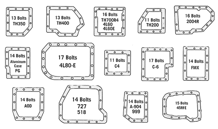

Sweet thanks. I'll check Rock Auto for prices. How do I tell if I have a 4L60-E or 4L80-E transmission code?
