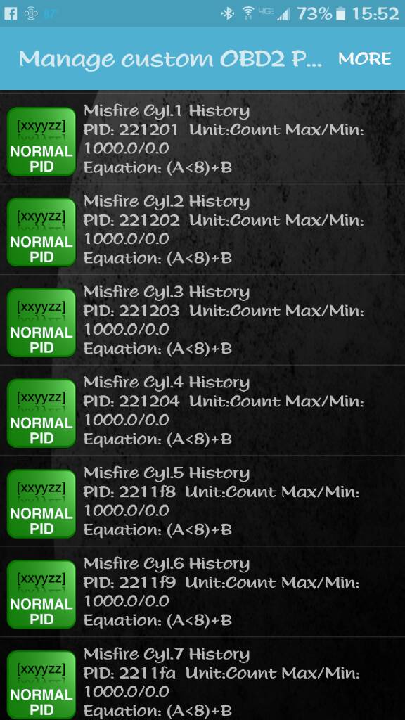

As far as misfire info, if it gives you a code it will typically tell you what cylinder is having an issue.. depending on the car type.

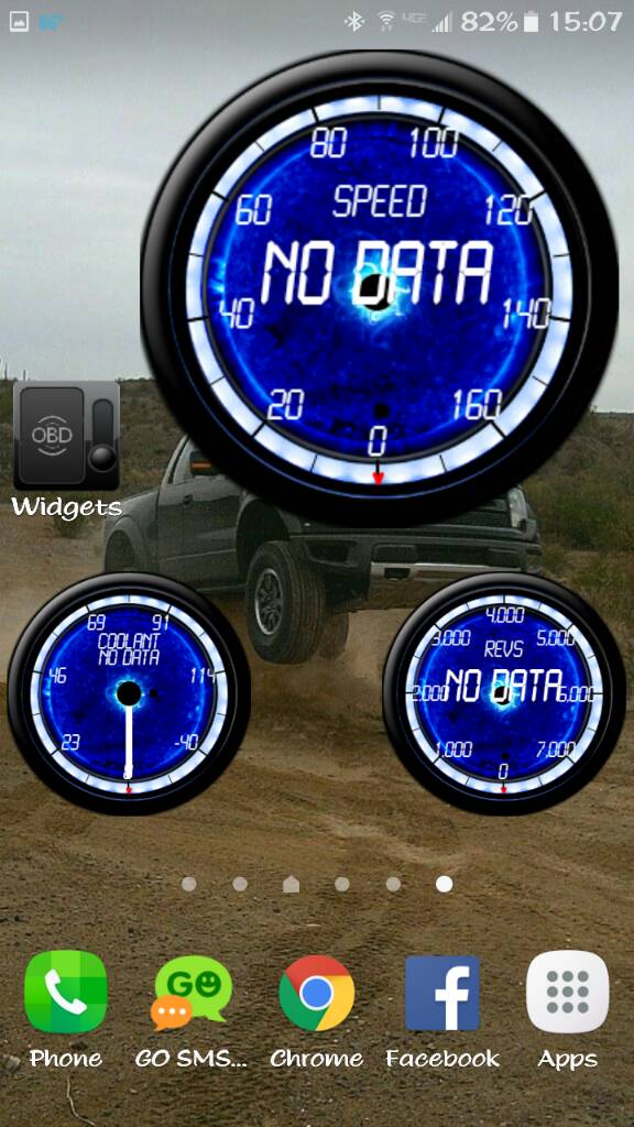

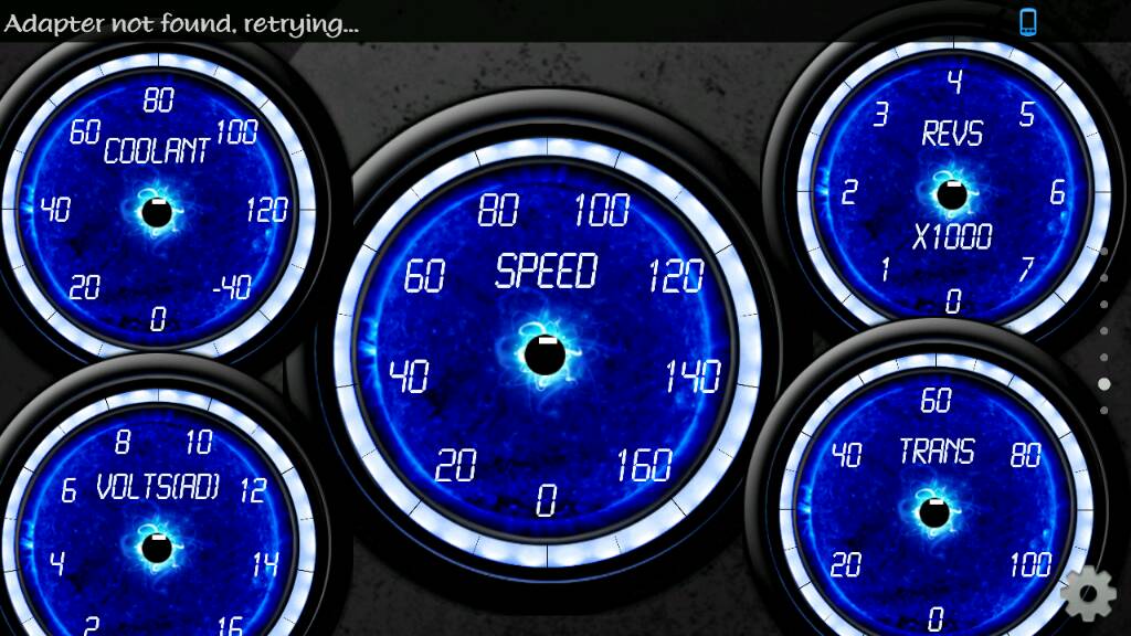

Under the live data, it shows you the info of every gauge, and pretty much every sensor depending on the car. I can usually see voltage, o2 sensor info, cooling temp, fuel pressure, oil temp and Trans temp in some cars. And you can set up the dash board with whatever gauges you want.
It will also give you 1/4 mile times, 0-60, top speed, GPS, mapping, mpgs... pretty much anything. It doesn't work switches or power stuff off and on like a dealers scan tool would, but it gives you tons more info than autozone can. Also comes in handy when you're working on something. You can have the phone or tablet under the hood with you so you can watch your gauges.
And now you can pay an extra buck or two for the widgets and have them up on the screen without even opening the app.
I love it.. no way you're going to get better for 25 bucks or less.
