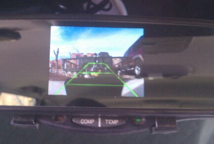

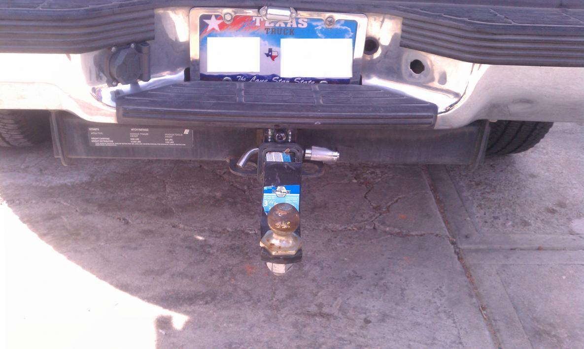

check out the install bros
let me know that u think
