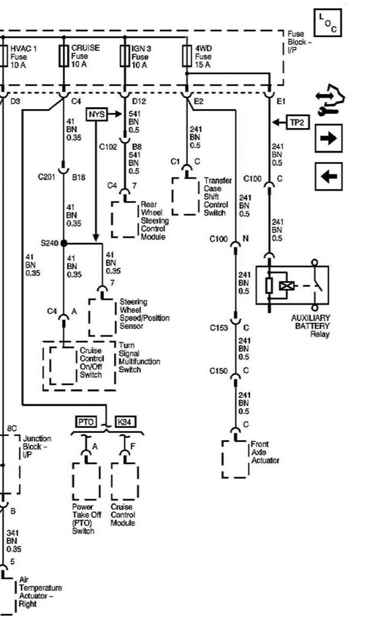

Schematic
Looking through a factory service CD that I purchased for a wiring schematic that would show how the wiring would run from the battery relay to the fuse box and this is what I found.
The hot wire connects to the 4WD fuse in the fuse box, at least that's what I see in the diagram.
Could this be correct? How would I go about wiring this?

Wire 241
Ok. I think I figured it out. On the schematic, there is a number (241, Ignition 3) shown. I was thinking it was to a field or group related the fuse box. Just out of curiosity, I searched the CD for the junction box connector diagrams and looked for 241 to see if there was a relation, and there it was, the 4WD power wire is at wire 241 in the harness, and also shown in the fuse box diagram.
When I looked up the harness schematic for the XL, it differs somewhat from the Sierra / Silverado, since the XL doesn't have the auxiliary battery set up.
The 241 wire is present in the XL harness, but it does not connect to anything in the fuse panel. Tracing the wire through the fuse box, there is a plug set, #C100 that goes from under the dash, through the firewall to a harness from the engine side. From the engine side, PIN C is where 241 should be. To the dash side of the harness, there is no wire, so I think I will add a wire to the dash side of the connector where the 241 wire would be present, add a 15 amp fuse and run that to the battery relay.
The ground I will source by the fuse box since ground schematics for the 241 wire lead to ground points by the engine.
Going to order the relay connector Monday.

Omar's link was the help I was looking for.
Thank you very much.
The install was identical to what was pictured, but Omar's pics for the C100 harness made sense of what I found in the schematics. I also learned something new about the Ign 1 and Ign 3 set ups, which I didn't think was possible.
