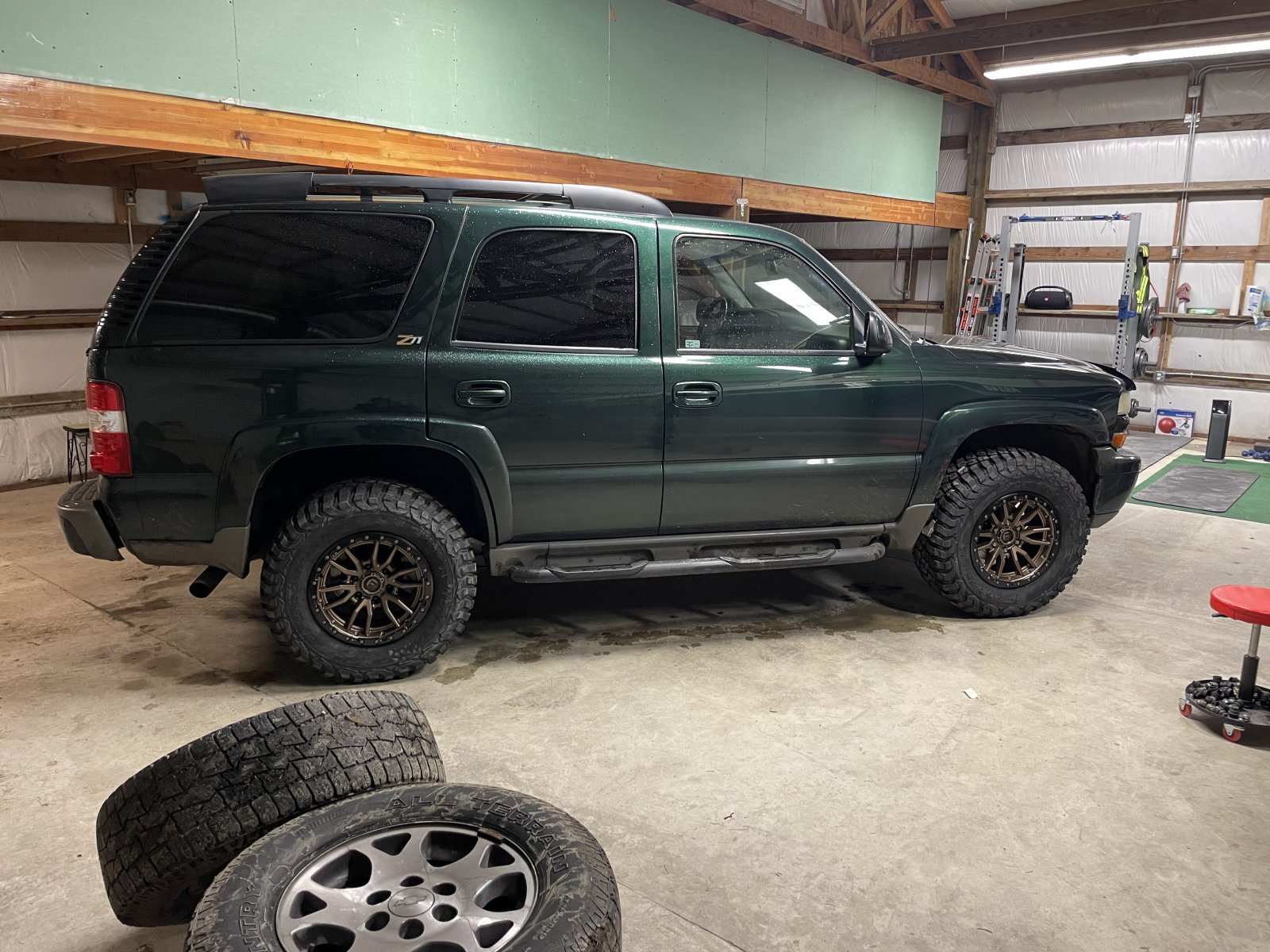

i have 17x9 pacer lt mods -12 off set with 285/70/17 no name a/t tires on stock keys maxed out
truck sets almost perfectly level and just barely rubs the inner plastic at full lock when backing out my drive way

Looks good! How about a pic down the side so we can see how much or if they stick out?
