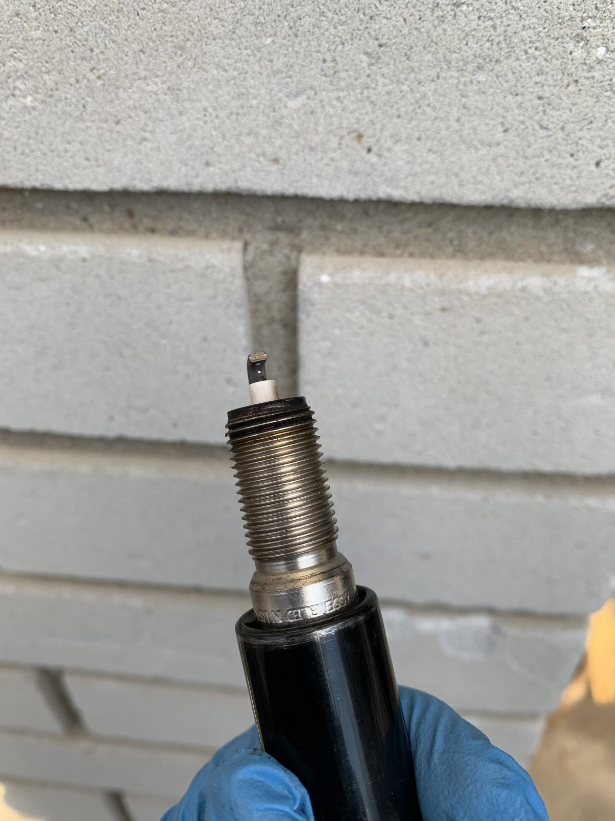

a little bit of update
checked today my new spark plugs after 1500miles and no oil on them. picture of #3 spark plug that was oily before

I'm in Canada and yes, it was a quick oil change station and I had a chance to look underneath and was pretty clean
Please stay out of quick lube garages. If I do not go to the dealer I just bring my 0w20 Mobil 1 and AC Delco filter to a independent shop that I know and let him do it. But that is just me.
