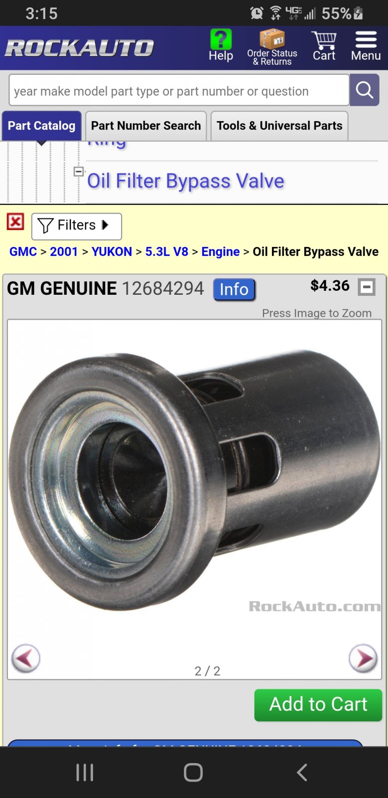

if that's they truck link, the valve there. arrow pointing to it.
I never knew that was a valve. I know it's not adjustable and that there is an o-ring under it that can start leaking and need replacing. I just thought it was a blocked off port for some unknown application, lol
Most people on here don't know what that port is for either, it's been discussed in other threads. Glad you shared this knowledge with us, and now we know
ahh I hadn't see the threads.
I believe this is valve under itself and can be replaced.

Weird, the listed vehicles this valve fits is 80s-mid 90s trucks/suvs and 2006-2014 vettes.
I wonder what's different on ~2000+ trucks/SUVs that this isn't used.
