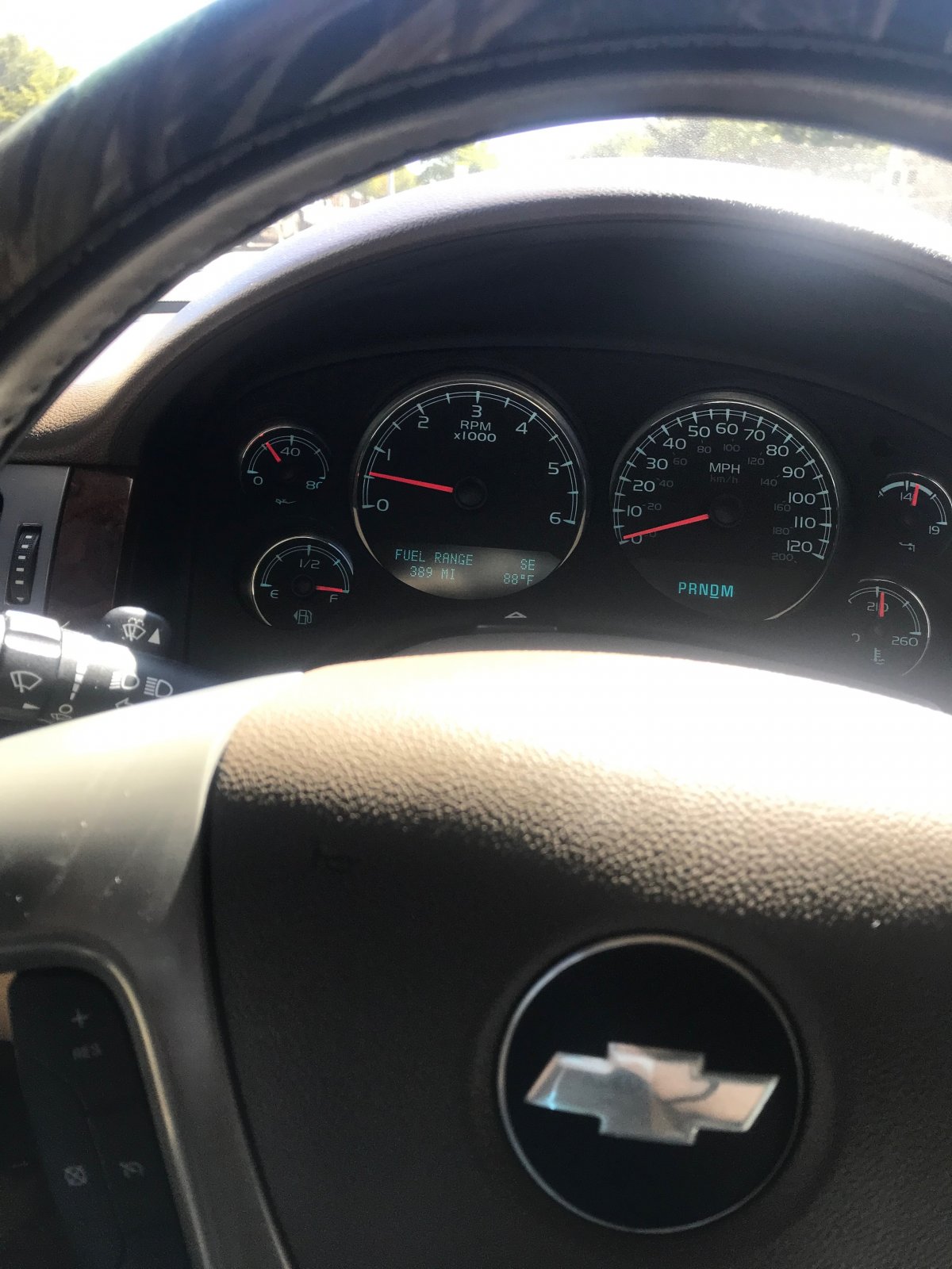

cool so if it is LMG which it probably is then the oil pressure i described and sent in that pic are normal?

It is an LMG i found it in the glovebox
Yes, once hot, after driving a while, it will drop into the 20s on the gauge at idle or stopped at a light. I forget exactly but the bypass spring on the LMG is somewhere in the 40s.
Aluminum blocks see a little bit lower pressures but they pump more volume because of tolerances.
