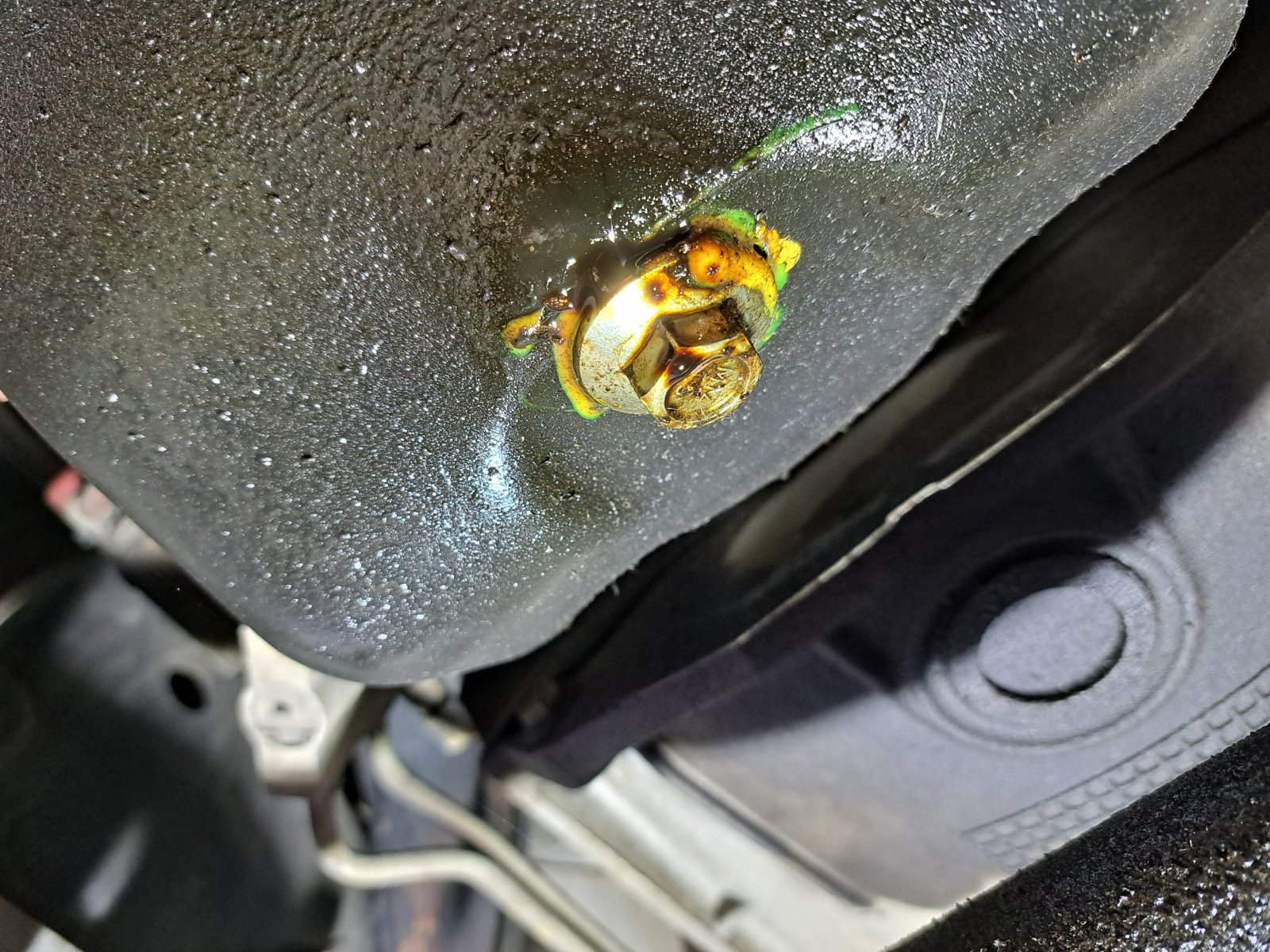

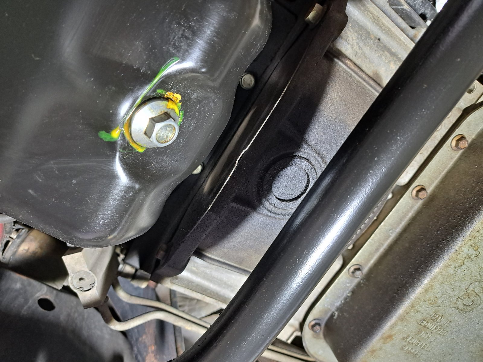

I looked under my neighbors F150 the other day for an oil leak. He has only been to Jiffy Lube and the dealer for oil changes since he bought the truck in 2006. The whole under area was dry except for one place. It actually had oil drip on the drain plug and what looked like to be 3M Weatherstrip Sealant squeezing out under the head of the drain plug. I put a wrench on it and tightened as much as I dared, about 1/8" turn and stopped. I believe the oil pan threads are stretched. I am going to do an oil change this weekend and I have already gotten a new drain plug and seal for it. He had every invoice for everything thing that has been done and it only mentions the "oil leak" 2 times on the Jiffy Lube tickets but none on the dealer tickets. He has been seeing the oil for the last 3 years, drops on the ground and adding as needed. Someone saw it and should have brought to his attention but is trying to hide with the "Gorilla Snot" around the drain plug. Two pics. A before and after I wiped dry and tightened and you can still see the oil seep at the lower area and soon to be a drop. I told him the same thing. I don't trust anyone but myself for any fluids when buying and always change them all to get a base to start from.
