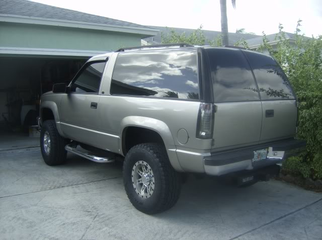

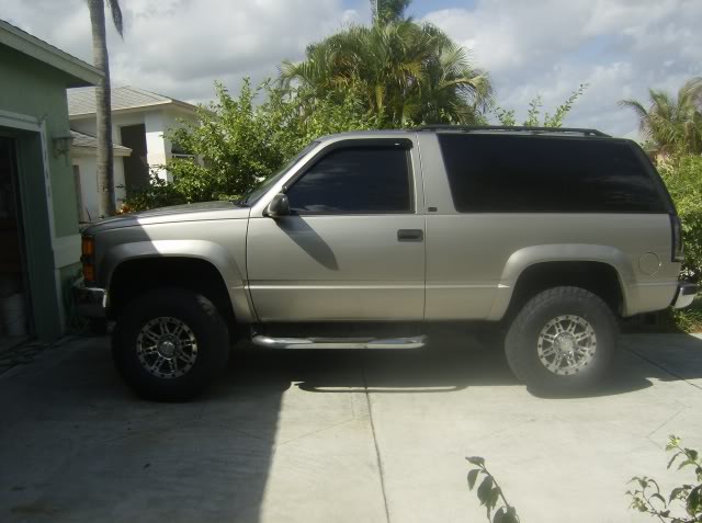

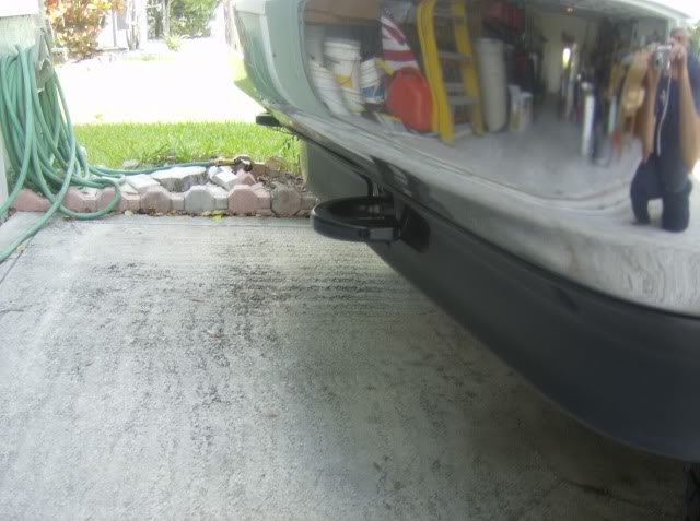

OK finaly some pics of the first lift stage.
Drumrunner
Sep 25, 2010
40
West Palm Beach

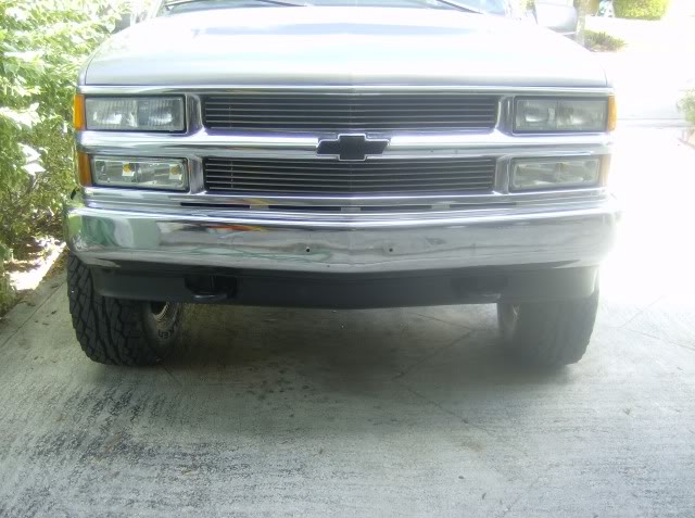

I did a 3 inch bodylift with gap gaurds and rear bummper relocation.
iWent ahead and debaged, painted the bowtie, and made a shorty anttena out of the stock one.
While i was at it i fabricated some spacers for the tow hooks.

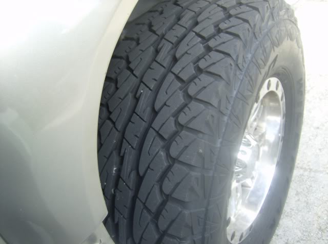

Here are some pics of the new Falken Wildpeak 305-70-16's

Wow you made that body lift look really good! Can you answer a couple of questions?
how did you relocate your rear bumper? Do you see any rear frame hanging down below the bumper?
What did you use to make the tow hook spacers?
Are your nerf bars modified at all to fit with the body lift?
What brand of wheels are those? Just wondering about the backspacing and offset.
Your truck looks really sharp. Hope mine can look that good one of these days!

I didn't modify the nerf bar mounting they are still stock height. (But more usefull that way) The wheels are Pro Comps 16x8 with a 4.5 backspacing. The rear bumper is a Zone offroad kit. The spacers for the tow hooks i made out of 1" heavy duty pipe. 1" on the rear of the hook and 1 1/4" on the front to get them back to the factory look.
