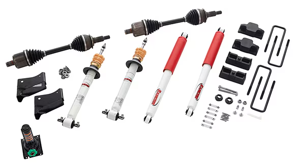

Stay with 2" lift like the kit GM sells with the new struts and CV axles or the cheap level.
3 inch suspension lift starts to make the angles of the suspension and drive components wonky and really need to go to 4 inches or more with drop brackets to make it reliable. Of course then you need larger tires and that exceeds what you are looking for.
This kit is basically an AT4 or Z71 upgrade. I "think" it also includes new rear spring packs.

Isnt this for PUs with read leaf springs?
