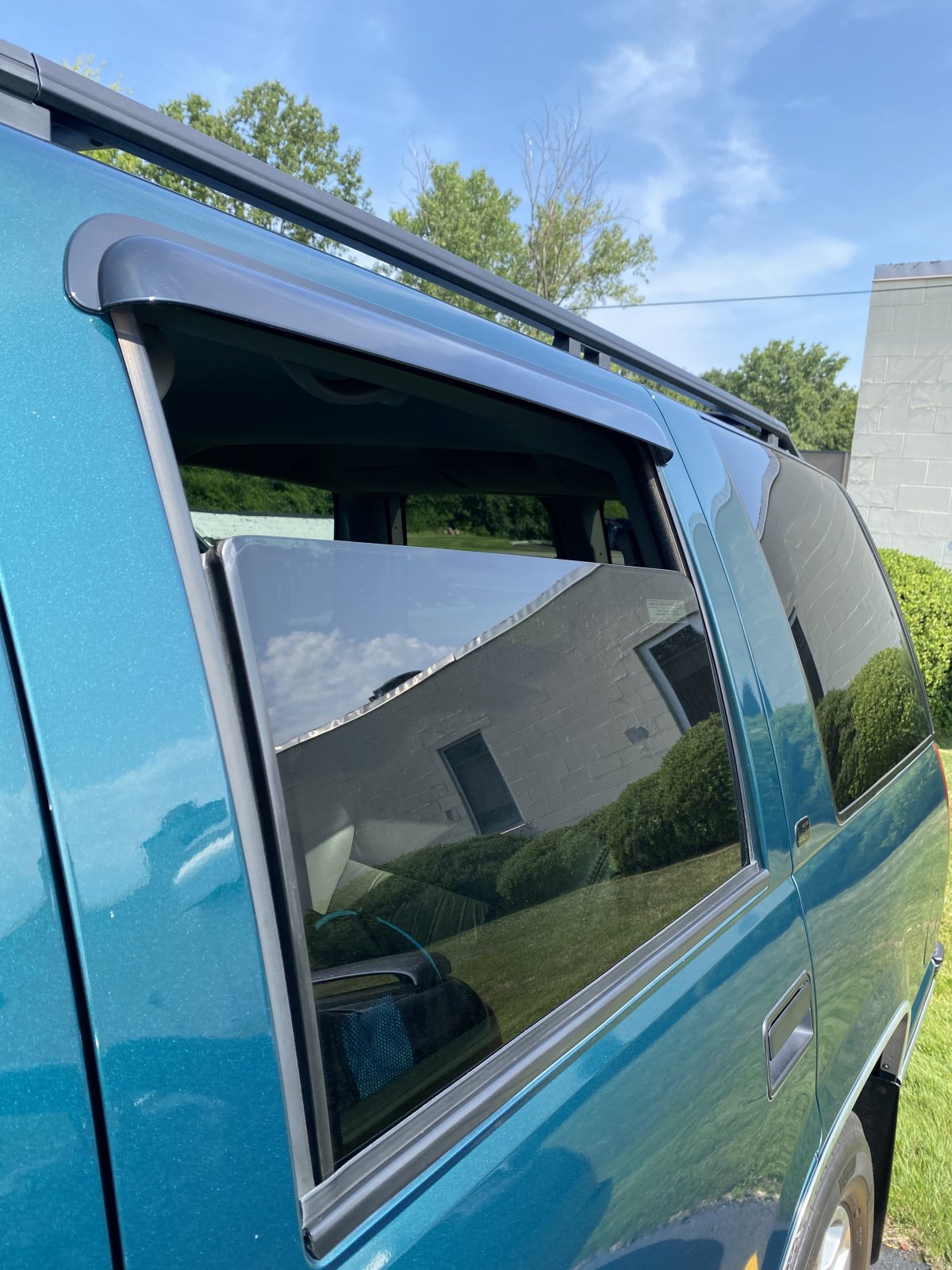

Wasn't sure where I should have posted this. Interior section or Exterior section? All depends on whether you're looking at the window from the inside or outside I guess.
'99 Tahoe, 4 Door
The rear windows have some type of limiters that prevent the window from rolling all the way down as you can see in the pic. Can this be overcome without getting too involved? I want to have these windows roll all the way down. I don't care if the kids fall out lol.

I would wager there is a cable stop of some sort. My 2007 yukon go halfway down, my 2017 go all the way down. They are all the short wheelbase ones. I'd say pull the door panel off and have a gander at the mechanism

Those windows go down further then that factory, they are just a couple inches up from bottom.
Does the power door locks work properly, I've seen multiple obs suvs do that and it's always been the door lock actuator rivets which are aluminum break and the way it falls its keeps the glass from going down

It’s definitely worth me looking into that at some point.
