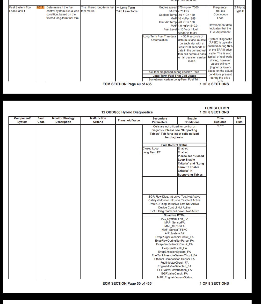

what are the long term fuel trims 1 vs 2 while driving like you were when it set.
I see over over that a tech 2 will show you the snap shot data recorded while the code was set. while I know the ecm saves this, I've never been able to access it. if you can find a scanner that will, or a listing I've missed, that should tell you what you need to know.
j91z28d1
Feb 28, 2022
3,058
3,779
not your exact truck, but to give you an idea of what the ecm perimeters look like for setting that code.

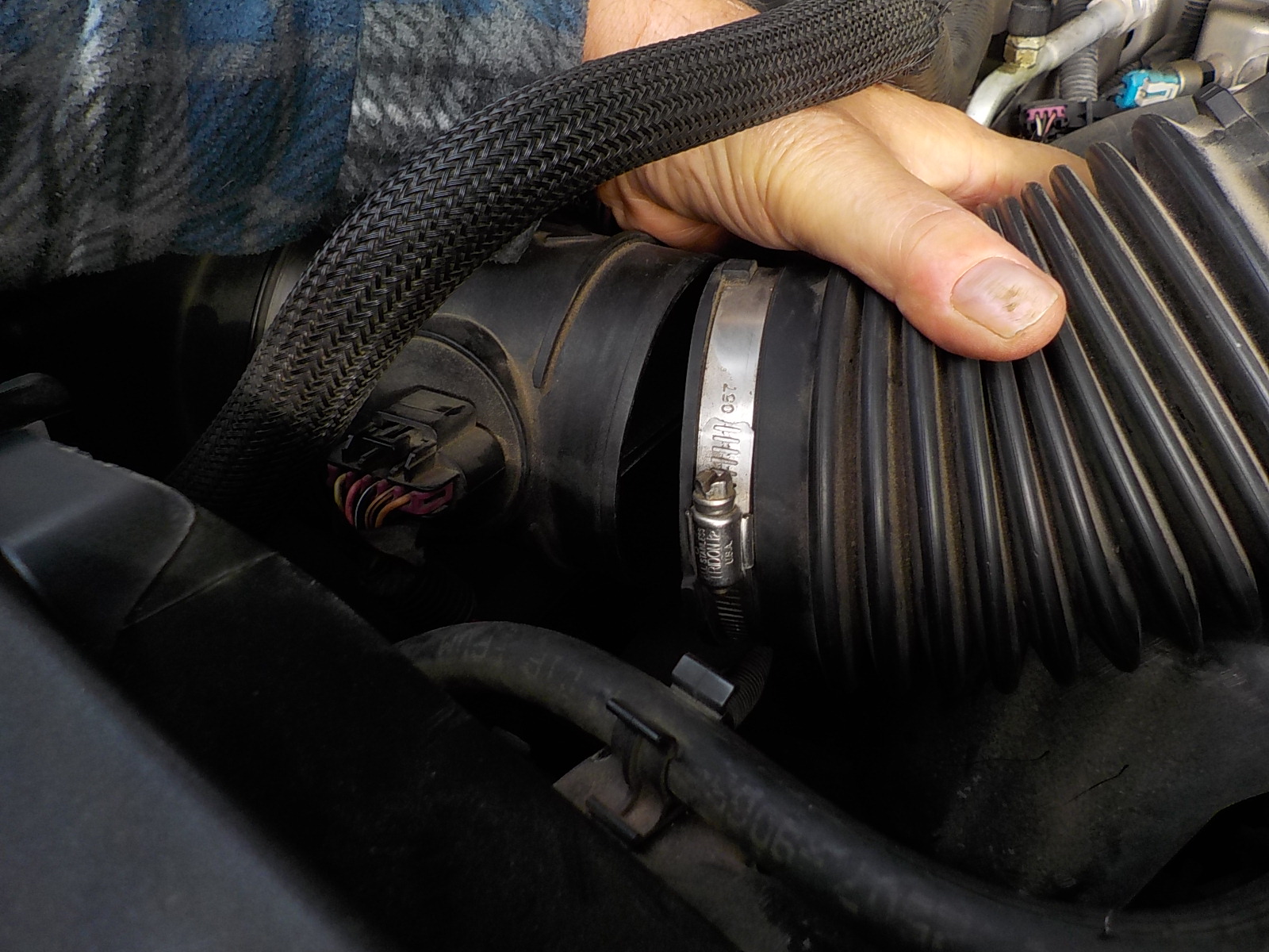

I think I found the P0171 problem?
11/17/23
MILEAGE today– 191,577
Found air intake hose had popped loose. I last tightened it on 8/21/23 @ 190,200 after cleaning MAP sensor.
So, I spray cleaned the MAP sensor and reconnected hose.
Cleared P0171 code.

Theoretically that should cause lean codes on both banks, but time will tell Good catch!
